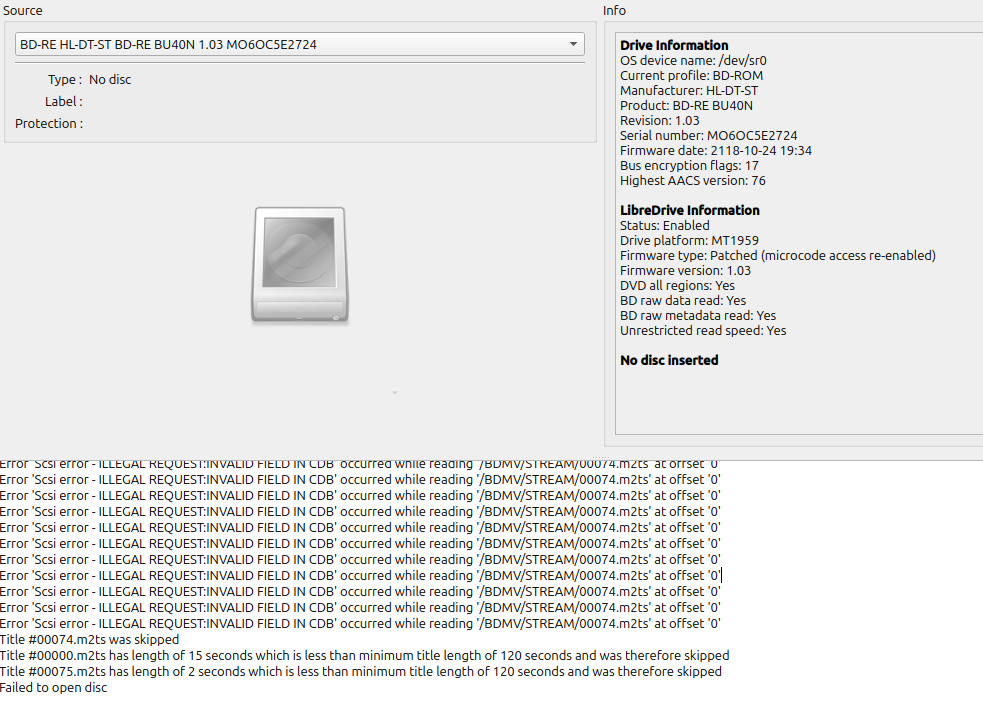

hello, having trouble with my BU40N. Was able to use it to save DVD and Blueray videos fine. Went through the process of updating the firmware to allow UHD movies. After using the GUI to update the firmware, I was able to save the 1st LOTR movie, but now it won't save anything. Have reflashed, even via the MakeMVK built in program following the video guide (have dual boot on my main computer).
Linked to below is the drive I purchased, the 2nd drive I bought for the case to do the flashing (read about the issue with archgon cases). And a screenshot of MakeMVK showing my drive information and the error I'm getting.
One thing that's odd, is the 1st movie worked while keeping the drive in the 2nd case. But after the 1st movie, it'll randomly disconnect after clicking on the drive icon to load the movie info. When I use the original case, it won't randomly disconnect, but it does what's shown in the screenshot.
If this is a lost cause, I'm ok buying a new drive (please point me to a good one for UHD). But certainly would prefer not to if I can avoid it (they are pricey. lol)
Thank you!!!
amazon.com/dp/B07BC9F98J?
amazon.com/dp/B0FXWD7G7J?
Posts: 6000
farmboy wrote: Thu Mar 19, 2026 12:10 am hello, having trouble with my BU40N. Was able to use it to save DVD and Blueray videos fine. Went through the process of updating the firmware to allow UHD movies. After using the GUI to update the firmware, I was able to save the 1st LOTR movie, but now it won't save anything. Have reflashed, even via the MakeMVK built in program following the video guide (have dual boot on my main computer).
Thank you!!!
you have a power issue try a higher powered usb port or get a powered usb hub

Billycar11 wrote: Thu Mar 19, 2026 12:48 am
Thank you!!!
still having an error. switched to a desktop so there is better power available. Got it so it doesn't randomly disconnect. But will still fail. Screenshot below. There is an error that comes up about "downloading latest HK disabled or failed". Not sure if that is relevant? 1st time it tried to download that, it just sat there a while and failed.
Posts: 6000
farmboy wrote: Thu Mar 19, 2026 3:07 am
you still likely have a power issue if the dive is showing no disc in the middle of trying to open it
try a high powered usb hub 35+ watts
oh wait your on linux downgrade to 1.00 then try again
nicholfd
Posts: 365
Post by nicholfd »
"HK Download" error - MakeMKV needs internet access to download keys. It is enabled by default. Check internet or confirm setting in MakeMKV allows Internet access. I *think* some downloads are from Russia(?) - make sure your FW/router is not blocking Regional IP addresses.
Download failure is not related to the SCSI error messages - those are still power related.
Desktop does not necessarily equal better power.
Use a "Y" cable w/2 x USB port connections, AC adapter (if chassis supports it), or a good, high amp output USB hub.
