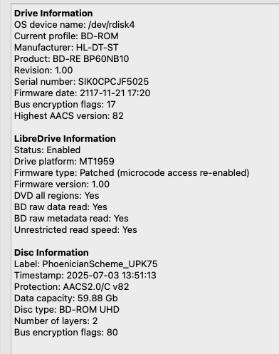

The guide in the first post is great. I deeply appreciate the effort and work BillyCar, MartyMyNuts, et all put in. Really excellent. But it's also very generalized. So here is what I did, using their work, to get my specific drive working. The hope is just to help people with the same setup have more specific directions. (Or maybe just for me if I have to do it again ever)
The drive is a WP50NB40 "LG Super Multi Blue Slim Portable", service code NB52. Flashing from a Mac on Tahoe 26.2.
This zip file has all required files. (MakeMkv 17.7, the two firmwares, sdf.bin). Copied out of the first post, just the ones you need, in one place. - https://drive.proton.me/urls/1HPEN2MT1W#9N7T0ZFU5SdL
1. Install the old (17.7) version of MakeMkv. Try to open it, get the security warning, bypass the warning in "System Settings -> Privacy & Security -> Open Anyway".
1.b. It won't actually run after that. Just crashes when you try. Doesn't matter. We're just going to be using a utility installed with it, from the command line. When we're finished with the flashing, we can remove this old version and use the current version.
2. Open the terminal. Change your working directory to /Applications/MakeMKV.app/Contents/MacOS/ ( "cd /Applications/MakeMKV.app/Contents/MacOS/" )
3. Run the command "./makemkvcon f -l", copy the part that says "/IOBDServices/XXXXXXXX" to notepad.
4. Copy the two firmwares and sdf.bin (from attached zip) to /tmp ( "cp 'path to where you extracted them' /tmp" )
5. Flash the first firmware, "HL-DT-ST-BD-RE_BP50NB40-NB50-1.03-NM00800-212005070917.bin". The current firmware is encrypted, so the command is the second one in the guide.
5.b. It's easier to write the command in notepad, and copy it into the terminal. So copy this, replace the XXXXXXX with the numbers you copied earlier, and then paste into the terminal.
./makemkvcon f -d '/IOBDServices/XXXXXXXX' -f /tmp/sdf.bin rawflash enc -i /tmp/HL-DT-ST-BD-RE_BP50NB40-NB50-1.03-NM00800-212005070917.bin
6. Unplug the drive, wait 5 seconds, plug it back in.
7. Run "./makemkvcon f -l" again, if the numbers changed, copy them into notepad again.
8. Flash the second firmware, "DE_LG_BP60NB10_1.00_MK_HBD.bin". It's no longer encrypted, so use the first command from the guide.
8.b. Do the whole copy it into notepad, paste into the terminal dance again.
./makemkvcon f -d /IOBDServices/XXXXXXXX -f /tmp/sdf.bin rawflash main -i /tmp/DE_LG_BP60NB10_1.00_MK_HBD.bin
9. Unplug the drive, wait 5 seconds, plug it back in.
10. Install the latest version of MakeMkv, see your UHD.

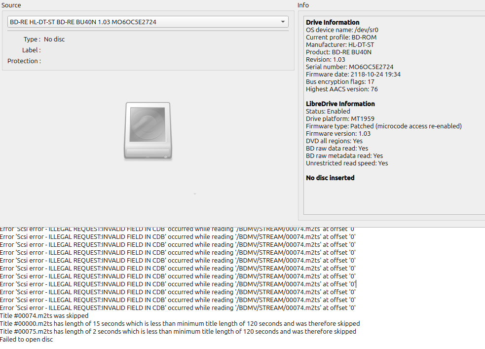

The Ultimate UHD Flashing Guide only suggests: "BU40N on any Firmware directly to > BU40N 1.03MK".
Last month I purchased two "new, old stock" Hitachi/LG BU40N drives from China. Following the above advice I flashed them to BU40N 1.03MK. They then showed "LibreDrive: enabled", but I found that they would could not process 4K UHD disks, giving the "Can't read AACS VID from disc - most likely current AACS host certificate is revoked by your drive" error. The wrinkle is that they processed standard Bluray disks just fine.
I found a comment by u/MartyMcNuts on another thread, which suggested that a LG BU40N drive with original FR07 firmware should be flashed to the "DE_LG_BU40N_1.00" firmware. In other words it needs the 1.00 firmware, not the 1.03MK firmware. I tried this and everything works now, both drives now process 4K UHD Blurays as well as standard Bluray just fine.
The manufacturing dates for these two drives were September 2019 and November 2019. Here is the initial drive info:
OS device name: /dev/sr0
Product: BD-RE BU40N
Revision: FR07
Serial number: xxxxxxxxxxxxx
Firmware date: 2119-05-10 13:48
Bus encryption flags: 1F
Highest AACS version: 63
I don't know what the rule should be, I have a different BU40N that worked right out of the gate with 1.03MK. I don't know if it is significant that these particular drives shipped with "FR07" firmware, or if it might be just the manufacturing date, or something else. At any rate, I found two other postings by people who were confused that their BU40N drives had trouble with 4K UHD in spite of standard Bluray working. It might be helpful if the Ultimate UHD Flashing Guide hinted that DE_LG_BU40N_1.00 firmware might be necessary in some cases.
Regards!

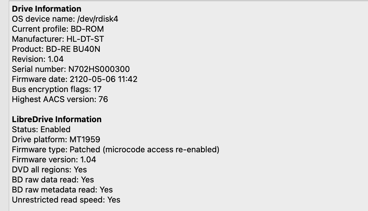

Apologie this must have been asked before I have a working LG BU40N on libredrive 1.04MK
It does read discs but is quite noisy at start up (awful seek noises). Would it benefit from a downgrade to 1.03MK ?
Sorry again if this has been asked 100 times:)

pope75 wrote: Mon Mar 16, 2026 9:17 pm Apologie this must have been asked before I have a working LG BU40N on libredrive 1.04MK
Probably won't make a difference
