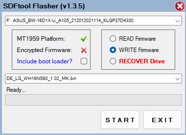

Re: SDFtool Flasher
Hi all,
After doing some investigation on Reddit in regards to flashing a 4K firmware onto my ASUS BW-16D1-XU drive, a user said I could use a firmware for what seems to be an LG drive (DE_LG_WH16NS60_1.02_MK) and it worked for that user. Trying to flash it onto my drive and it spits out an error, screenshots attached. I'm super new to this so any advice would be greatly appreciated!

Re: SDFtool Flasher
Take the disc out of the drive!epicchancellor wrote: Tue Mar 10, 2026 1:37 am Hi all,
