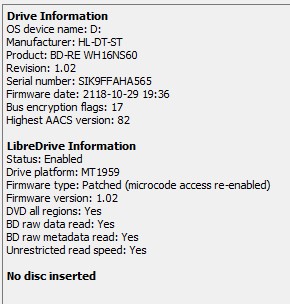

LG 16NS40. Successfully flashed to HL-DT-ST-BD-RE_WH16NS60-1.02-NM00100-211810291936.bin using the GUI flash tool. Here are the current reads on the drive from MakeMKV.
Screenshot 2026-03-01 133603.jpg (29.52 KiB) Viewed 1279 times
However, when I put a 4K disc in it just chugs for 10 minutes and then goes back to "No disc inserted."
Is there something I'm missing?

Prime wrote:
Sun Mar 01, 2026 8:37 pm
Thanks.
Make sure you have completely powered off/disconnected the drive after flashing (not just rebooting computer).
Make sure the disc is clean, even if it is new and/or looks clean. I've had fresh out of the box new releases that I needed to clean before I could rip them.
Thanks,
Frank
Posts: 4730
Thanks.
What was the MakeMKV drive info and libredrive info sections before you flashed it?
Is it an older, pre 2016 model? If so, it's probably the older, incompatible MT1939 drive platform.

It said MT1959 before I flashed it. It was on base 1.0 factory firmware. I did a full power cycle on the drive (which is in an external enclosure). The flash executed perfectly and updated to the information I posted.

I didn't have the thought to screenshot the before info. But LibreDrive was all good, it lined up with everything that the tutorial said I needed to have and have ripped many of my 1080p Blu-Ray discs with this setup.

Can it still rip standard blu-ray discs?
If it is manufactured after Oct 2015 (check the label on top of the drive) and MT1959 drive platform and was on an original firmware v1.02 or lower, it would already have been libredrive enabled and UHD compatible without the need for flashing.
Prime
Joined: Sun Mar 01, 2026 8:31 pm
Post by Prime »
Okay. So that sucks.
Womp Womp. Found the problem. I've got another one of these drives that's newer in another machine. Flashed it directly to 1.02MK today and it worked perfectly. Thanks for the help!
