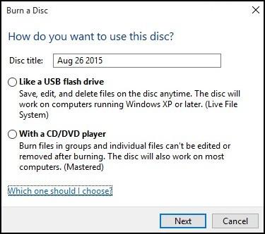

Okay, so I restart my computer to power cycle the drive. I inserted the UHD disk I wanted to rip and waited for the OS to initialize it. The OS acts like the disk is a blank DVD to burn on to and doesn't recognize it as a movie disk.
Here is what comes up:

As it is a USB drive, power cycle means disconnect the USB cable from the drive or computer for a couple of minutes before reconnecting. Arre you sure it is actually a 4k UHD disc?
A couple of months ago, I purchased a 4k UHD movie from Amazon (The Fantastic Four First Steps) and what I actually recieved was a blank DVD disc with the UHD movie label printed on the disc. I quickly contacted Amazon about this poor counterfeit attempt and returned it.

I did end up disconnecting the cable to the PC for a bit and then re-attached the cable. It is a UHD disk. I have watched the movie on my Blu Ray UHD player.
Edit: I just went back and confirmed it plays on my Blu Ray UHD player.
