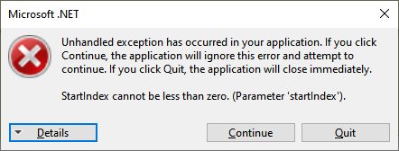

Update: I got it working by using the command line version sdftool.exe only. UI version still doesn't work.
Hi, getting this error window from SDFtool Flasher under Win10 64
Afterwards the tool starts but doesn't list the drives. Any idea how to fix that error?
I have 3 drives in total on SATA. I have flashed 2 before some years ago. Now I am trying to flash the latest one

************** JIT Debugging **************
Any help will be greatly appreciated.

cinerama19806
Joined: Thu Jan 15, 2026 10:25 pm
Re: SDFtool Flasher
#1575 Post by cinerama19806 » Thu Jan 15, 2026 10:40 pm
Many thanks for all your efforts here. Hopefully this one's an easy fix and I'm just missing something simple trying to use the SDFtool Flasher. (Side note: I previously successfully flashed an Asus drive but I don't remember when or how, and that drive has pretty much given up the ghost for burning and hasn't successfully opened a 4K disc in ages (lots of grinding) even though it's Libradrive enabled.)
I've now purchased a Verbatim external 4K drive from Amazon (not too many options out there now) which Makemkv is reading as
Product: BD-RE BU40N
Revision: 1.05
Serial number: MO6PAKA5435
Highest AACS version: 82
When I open the SDFtool Flasher for this drive I get the same error previously noted: StartIndex cannot be less than zero (which I believe is not a "show stopper". Once I advance to the software window, I don't see a drive available for flashing (i.e. there's no option available in the pulldown menu for the drive. I don't know if it matters, but I've removed my previous Asus drive as an option and have assigned the new drive the "D" drive letter. (I believe I'm OK with the flash version needed and it's available to me from the "all you need firmware pack" (LG Slim BU40N) - but I can't get there without being able to select a drive.) Please let me know what I'm missing here.
