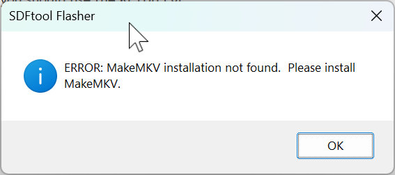

Also when I run SDFtool Flasher.exe I get this error and I have MakeMKV running.
The SDFtool Flasher (GUI front-end for native MakeMKV CLI flasher) expects MakeMKV to be installed in its default location.
LInk(s) to KeyDB.cfg in 1st post of Public KeyDB Disc Submissions.

d00zah wrote: Sun Dec 28, 2025 4:32 pm
Username:0000 wrote: Sun Dec 28, 2025 12:45 pm ...
I have now downloaded the KeyDB thanks.
