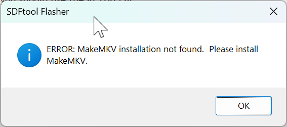

I have looked through the forums can I can't find the KEYDB.cgf.
Also when I run SDFtool Flasher.exe I get this error and I have MakeMKV running.
The SDFtool Flasher (GUI front-end for native MakeMKV CLI flasher) expects MakeMKV to be installed in its default location.
