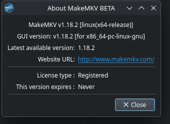

fedeb
Joined: Sat Dec 13, 2025 12:27 am
#3390 Post by fedeb » Fri Dec 19, 2025 1:04 pm
can someone update the post for Linux instructions?
The MKV for linux points to 1.18.2 version viewtopic.php?f=3&t=224
But this guide viewtopic.php?f=16&t=19634 tells that we must use 1.17.7 version
How we can install 1.17.7 if the only working version is 1.18.2 ?
