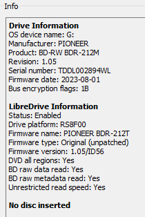

#116 Post by Vaako » Thu Nov 20, 2025 2:35 am
mike admin wrote: Mon Nov 10, 2025 10:38 pm
Vaako wrote: Mon Nov 10, 2025 7:11 pm Trying to get my Pioneer BDR-212EBK with FW 1.05 to work but without success.
Please send the firmware dump from this drive, MakeMKV should create the file (dump_fw_xxx.tgz) automatically.
@mike admin
It is working great !
Thank you so much Mike !!
Pioneer BDR-212EBK LibreDrive Enabled.PNG (10.18 KiB) Viewed 49638 times
