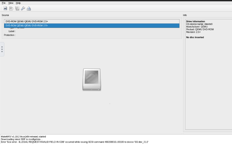

Or does the screenshot indicate anything else i could try?
Bildschirmfoto 2025-11-20 um 07.23.47.png (46.17 KiB) Viewed 15344 times

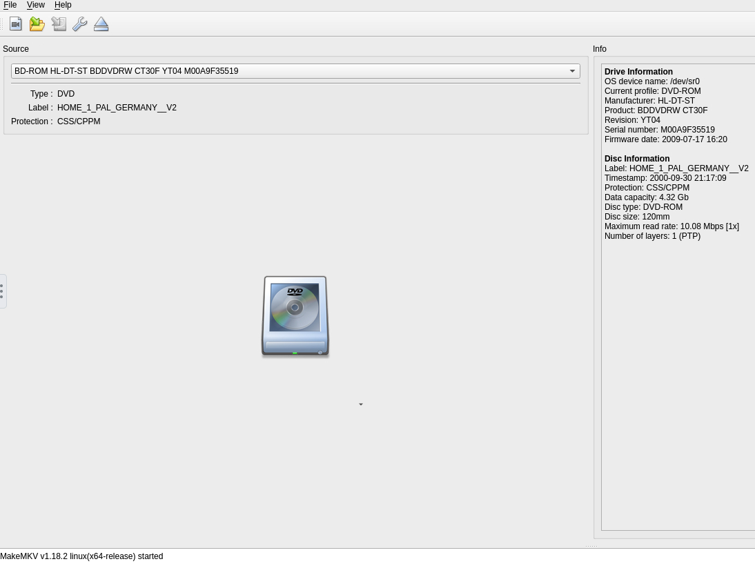

#4 Post by ionas » Thu Nov 20, 2025 8:51 am
Hello
pass through via Proxmox did not work (via the UI).
It was a generic "pass through standard dvd drive".
I had to pass the controller directly in the host OS.
1. Unbind the proxmox connection
2. bind raw PCIe device with ID
Sorry i have no further instructions - i used chatgpt for help but it works now.
An easier option would be to directly install it on the host os not inside proxmox / docker but i wanted to go this way.
