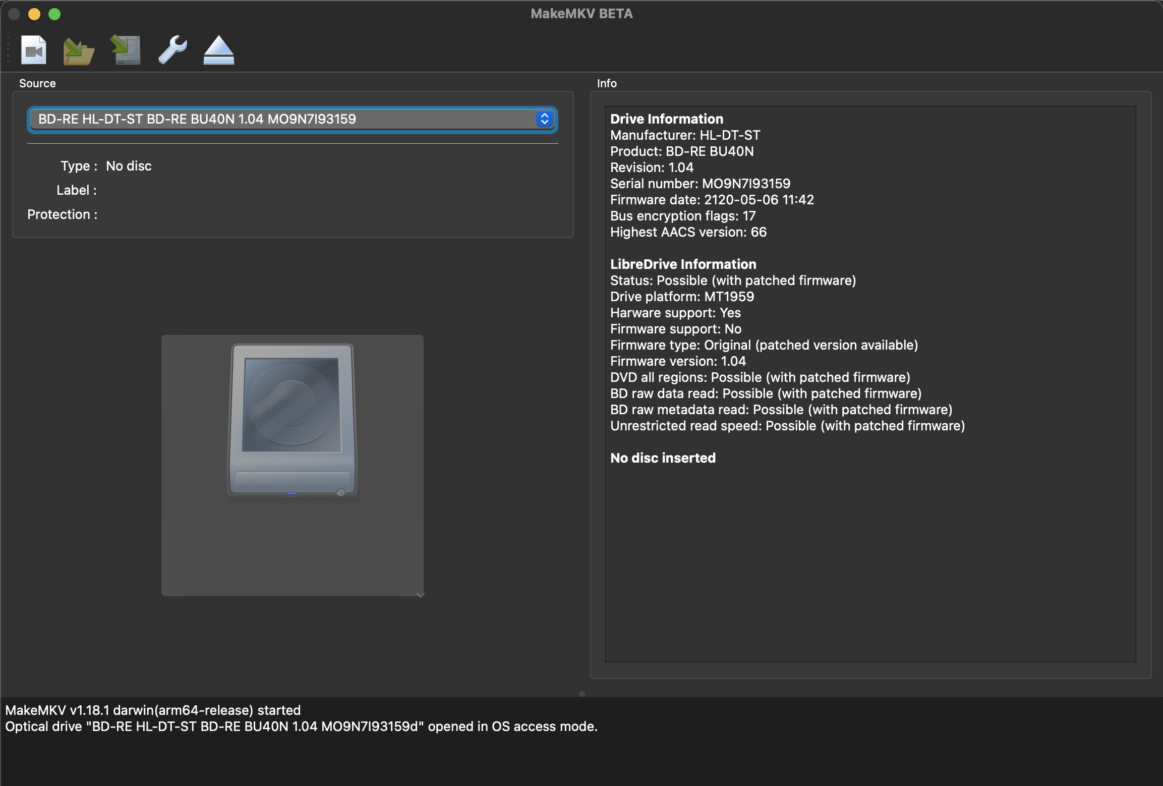

I am trying to downgrade a slim LG BU40N from version 1.04 to 1.03 using a mac.
Drive details:
LG BU40N before.png (376.13 KiB) Viewed 17972 times
I used the method laid out on page 1

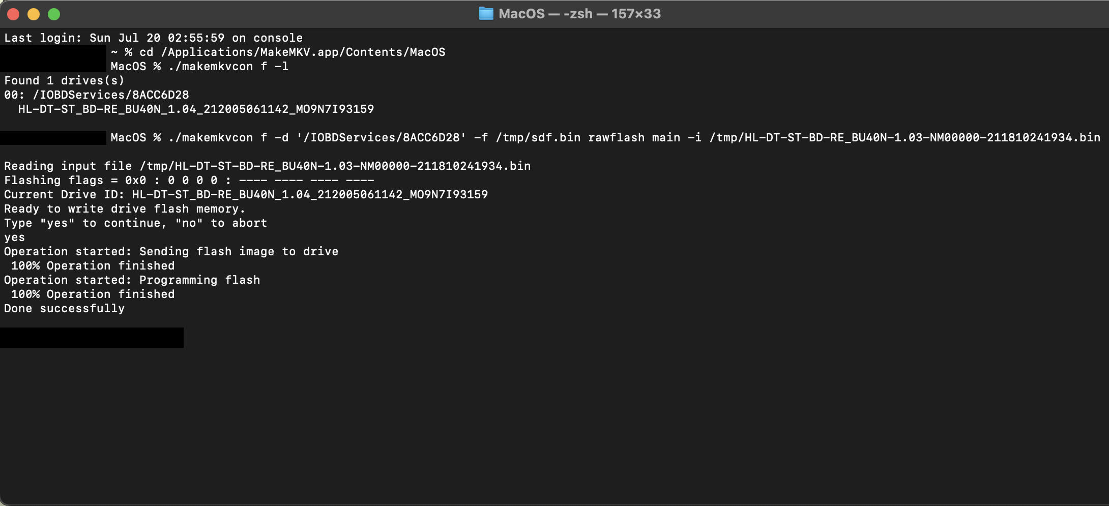

copied the two files "sdf.bin" and "HL-DT-ST-BD-RE_BU40N-1.03-NM00000-211810241934.bin" to the /temp folder.
Opened the terminal and followed the instructions:
terminal window.png (381.4 KiB) Viewed 17972 times

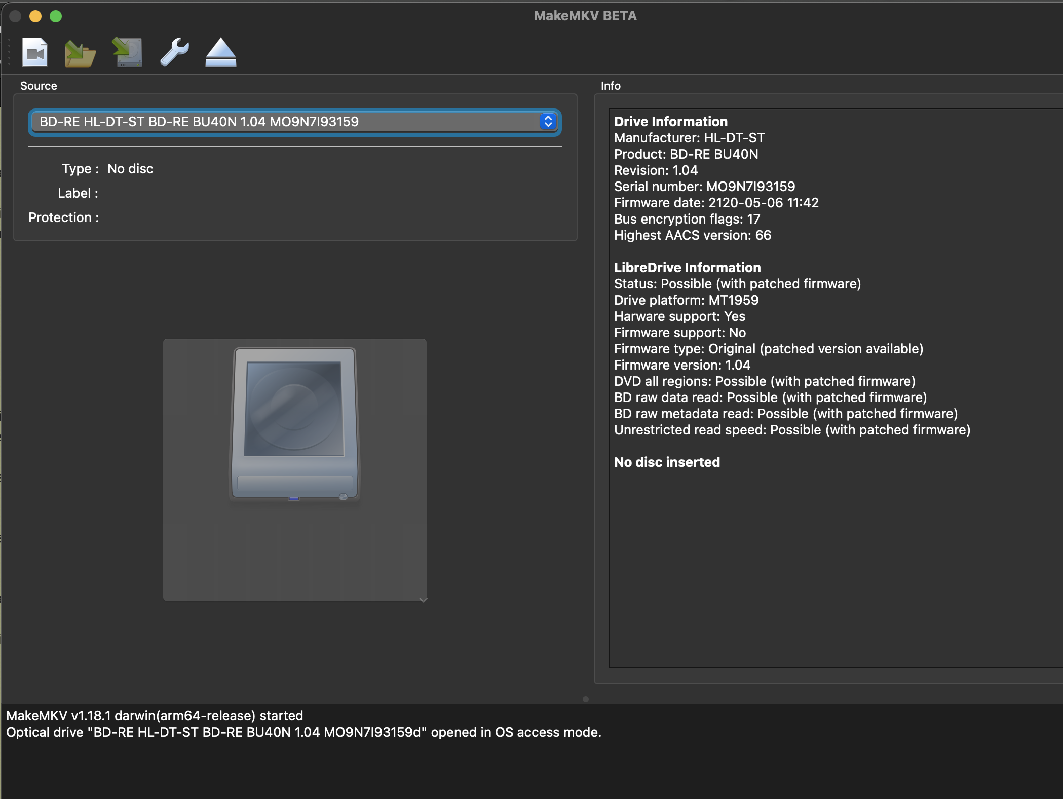

The terminal window shows that the flash was "Done successfully" but opening the makeMKV application show the drive is still on version 1.04.
LG BU40N after.png (386.26 KiB) Viewed 17972 times
Does any body know what i have done wrong ?

#3052 Post by d00zah » Tue Jul 22, 2025 1:07 am
wow001 wrote: Tue Jul 22, 2025 12:22 am I am trying to downgrade a slim LG BU40N from version 1.04 to 1.03 using a mac.
Drive details:
v1.04 is encrypted FW. Change 'main' to 'enc' in your command.

wow001
Joined: Wed Jul 02, 2025 8:11 pm
#3054 Post by wow001 » Tue Jul 22, 2025 8:45 am
Thank you d00zah "v1.04 is encrypted FW. Change 'main' to 'enc' in your command." worked
