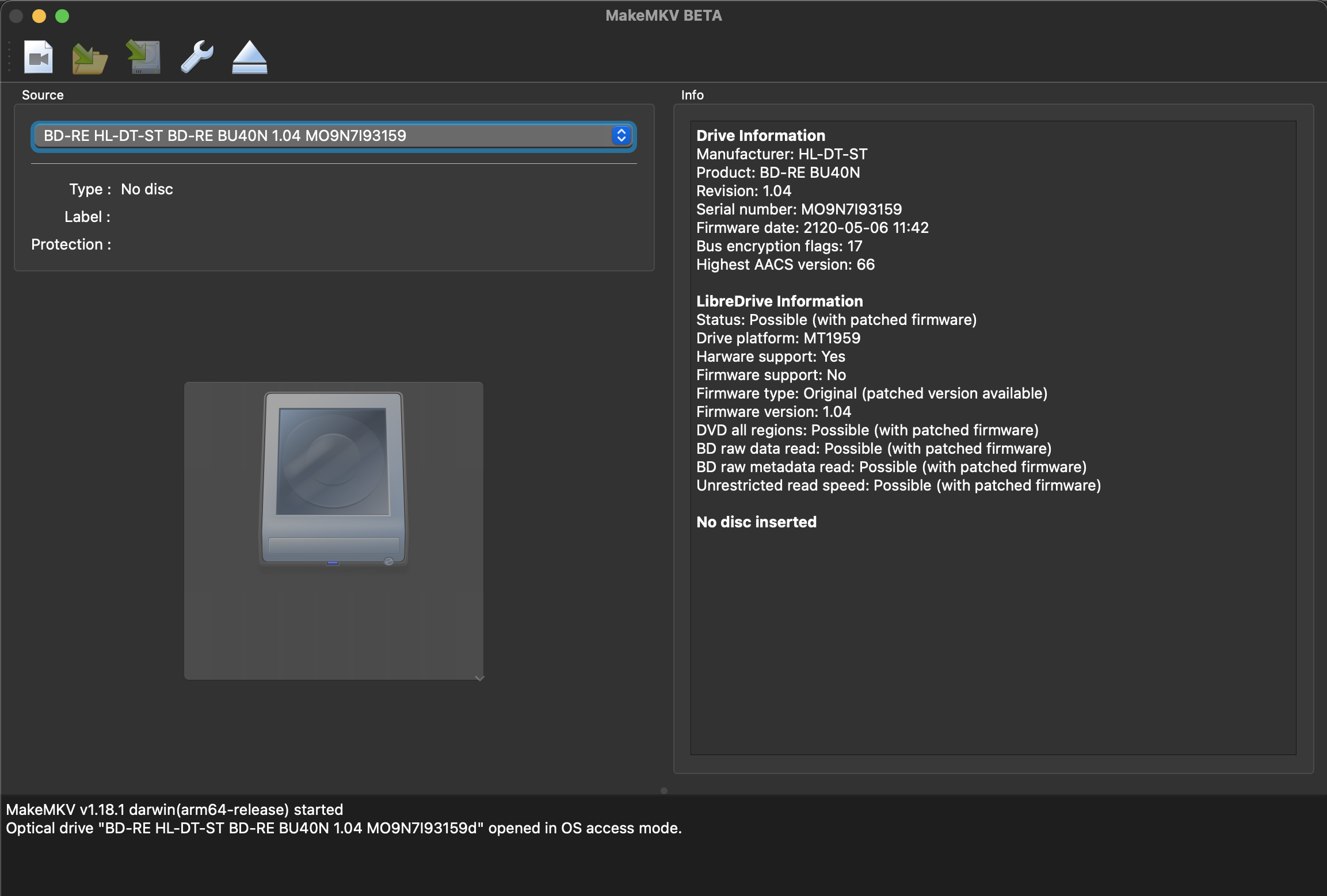

I am trying to downgrade a slim LG BU40N from version 1.04 to 1.03 using a mac.
Drive details:
LG BU40N before.png (376.13 KiB) Viewed 18816 times

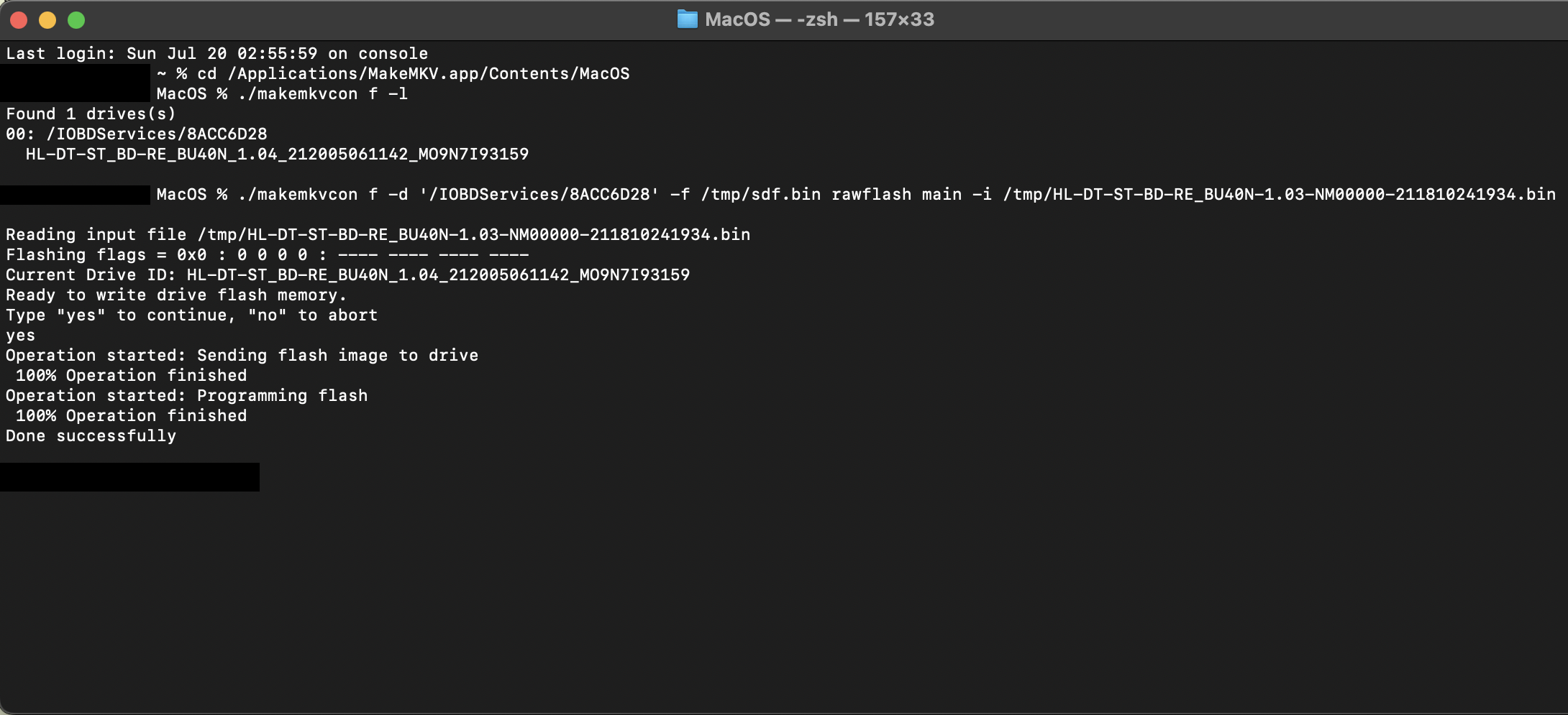

copied the two files "sdf.bin" and "HL-DT-ST-BD-RE_BU40N-1.03-NM00000-211810241934.bin" to the /temp folder.
Opened the terminal and followed the instructions:
terminal window.png (381.4 KiB) Viewed 18816 times

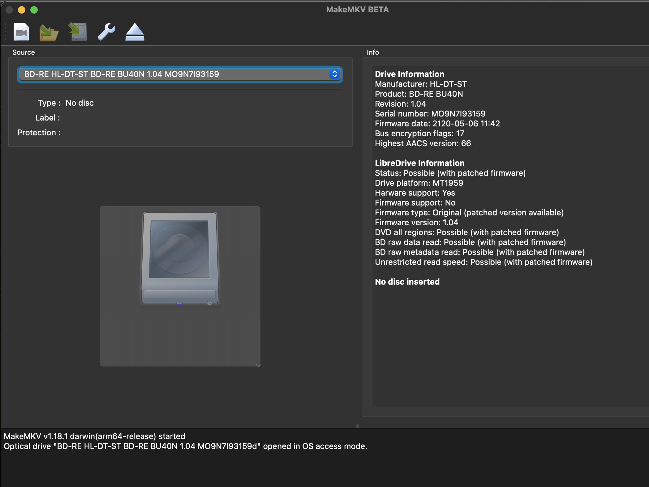

The terminal window shows that the flash was "Done successfully" but opening the makeMKV application show the drive is still on version 1.04.
LG BU40N after.png (386.26 KiB) Viewed 18816 times
Does any body know what i have done wrong ?

wow001 wrote: Tue Jul 22, 2025 12:22 am I am trying to downgrade a slim LG BU40N from version 1.04 to 1.03 using a mac.
Drive details:
I used the method laid out on page 1
v1.04 is encrypted FW. Change 'main' to 'enc' in your command.

wow001
Joined: Wed Jul 02, 2025 8:11 pm
Post by wow001 »
Thank you d00zah "v1.04 is encrypted FW. Change 'main' to 'enc' in your command." worked
./makemkvcon f -d '/IOBDServices/8ACC6D28' -f /tmp/sdf.bin rawflash enc -i /tmp/HL-DT-ST-BD-RE_BU40N-1.03-NM00000-211810241934.bin
