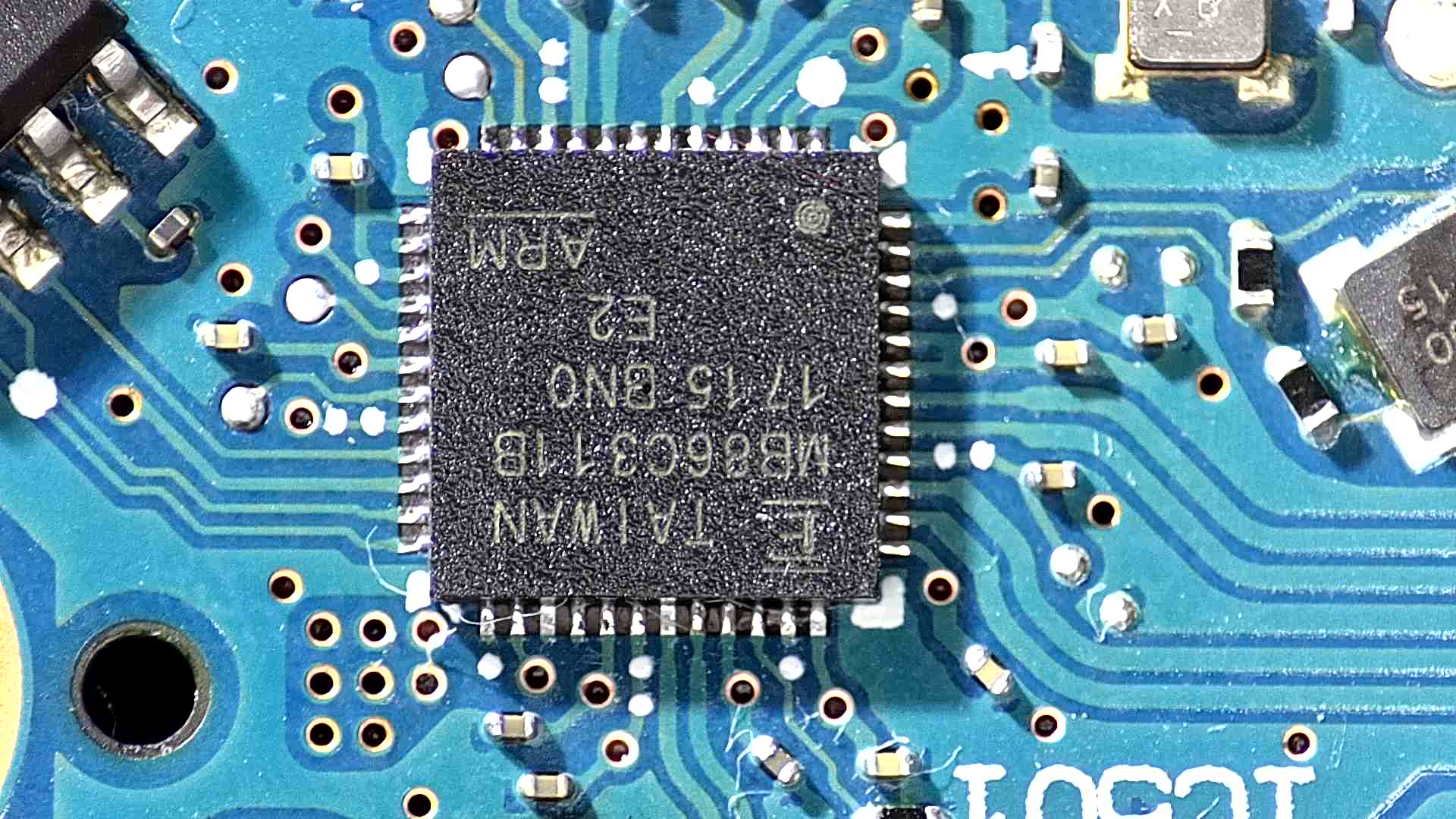

It looks like that IC is bad! I'm seeing voltages come into it, but no communication at all out of it. I've ordered a couple of replacements, as well as a the usb-c controller IC, just in case there's something going on there as well. It's worth a shot anyway. Here's some of the IC's on the board if anyone is curious about what's in there! I'll update when these parts come in... the USB/SATA controller is only available from china, so that might be a minute before it comes in :)
