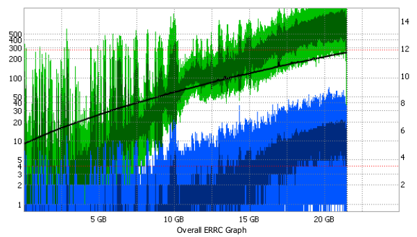

Sorry, forgot to address that. Disc scanning is where a drive with diagnostic commands enabled (like an LG WH16NS58 which is intended for people who do bulk disc duplication burning) is used to scan a disc for its burn quality. You may have seen disc scans like this:
It shows how much a drive's error correction is being used to make the disc readable - there isn't an error free optical disc on the planet, and without diagnostic software you can't tell if a burn is really good, or marginal. The error correction masks a marginal burn because you can't tell how close to the error correction's edges a disc is at. If you do a lot of burns, or are into hobbyist media scanning, it can use useful/fun. It's somewhat handy for UHD ripping because it can help you see if a rip problem is due to a flaw on the disc or not. There used to be a bigger hobbyist scene for this than there is now. I like to have the capability, but not everyone is interested.

If you are looking at slimline, I'm less familiar with those models. You can find info around here if you search. I have an older Verbatim branded drive that came with an OEM Pioneer BDR-UD03 in it that I cross-flashed to a BDR-UD04. It was my first UHD drive. You can still find those Verbatims around, but the new ones aren't Pioneers any more - they are now an LG slimline. Some of the older ones have BDR-UD03's, which you will need to get a firmware update for. Some of them have BDR-UD04's in them, which are good to go out of the box. This would be the very basic, entry-level Pioneer. Good news is that it's portable. Bad news is that it's a slimline, which you have to be very careful with lest you scratch discs.
Asus drives are made by LG. I don't know of any Asus drives with diagnostic firmware in them. The only UHD drive I know of with scanning diagnostic firmware is the LG WH16NS58DUP. Some Asus drives can be cross-flashed with LG firmware, but there are pitfalls to this and I don't know the compatibility matrix - search around the forum, there is info on that here. Scanning-capable drives are rarer nowadays. But the NS55 you mentioned earlier can be flashed with the NS58 firmware.kapqa wrote: Fri Jun 06, 2025 10:12 amis this scanning software thing exclusive to LG drives? was thinking also of ASUS drive since those are easily available via Amazon or similar for around 85 eruro.
- Posts: 4740
Re: LG flashed to LibreDrive no longer recognize BluRay - Orig. Firmware lost
All 5,25" drives with a M1959 chip can be flashed to do quality checks when flashed to WH16NS58 V1.5 from the MK pack. It will also rip UHDs but the support of media is quite restricted for burning. But everybody should stop burning discs as their quality is getting worse. You should look into solutions that work from HDD backup. Cheaper and safer than discs.
