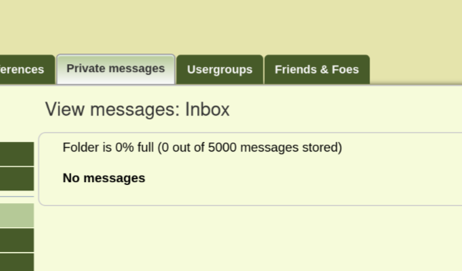

#196 Post by willie3204 » Sun Jun 01, 2025 2:45 am
Thank you very much coopervid. Though I dont see any PMs in my list :(
