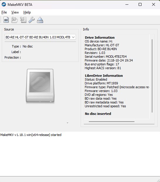

Hello, I just got my Archgon MD-8107S-U3-UHD, it was version 1.01, used the GUI to take it 1.03MK, then tested a disc.
Screenshot 2025-05-18 143054.png (37.47 KiB) Viewed 25203 times
No disc. Tried flashing to 1.00, no disc then too. Am I doing something wrong?
Posts: 4995
Re: SDFtool Flasher
seatopian wrote: Sun May 18, 2025 6:31 pm Hello, I just got my Archgon MD-8107S-U3-UHD, it was version 1.01, used the GUI to take it 1.03MK, then tested a disc.
Allow the OS to initialize the disc before opening MakeMKV.
Ensure MakeMKV has internet access as this is needed to download the UHD hashed keys.
Clean the disc with a microfiber cloth.
seatopian
Joined: Sun May 18, 2025 6:29 pm
Re: SDFtool Flasher
Post by seatopian »
MartyMcNuts wrote: Sun May 18, 2025 10:54 pm
Done all three, even tried another disc from the same set.
Posts: 4995
Re: SDFtool Flasher
seatopian wrote: Sun May 18, 2025 11:40 pm
What disc set it it? If it's GoT or LotR, these are well known as notoriously bad quality disc pressings.
Can you see the disc in windows explorer?
Does a normal BD disc work?
seatopian
Re: SDFtool Flasher
Post by seatopian »
German 4K of RoboCop.
Can't see the disc in explorer either. Normal BDs (even from the same set) work
Posts: 4995
Re: SDFtool Flasher
seatopian wrote: Mon May 19, 2025 4:47 am German 4K of RoboCop.
If BD's work, then the laser is fine. You may need to wash the UHD disc with soapy water and dry with a microfiber cloth. I'd then let it finish air drying overnight before testing it again. It's possible the disc may be faulty. Try another UHD disc.
Also, it sounds silly but sometimes a drive just doesn't like a particular disc. It happens... This is one of the reasons why most of us have multiple drives.
seatopian
Re: SDFtool Flasher
Post by seatopian »
Gotcha. For what it's worth, I also just now tried my US 4K of Alien and it's not reading either. Will try to clean all three tomorrow! Thanks for the help.
EDIT: a little bit after i posted this, i decided to double check and now it's stalling out on regular BD discs. think i got a faulty drive.
Posts: 4995
Re: SDFtool Flasher
seatopian wrote: Mon May 19, 2025 6:06 am Gotcha. For what it's worth, I also just now tried my US 4K of Alien and it's not reading either. Will try to clean all three tomorrow! Thanks for the help.
Yeah, possibly. Maybe return it and get something else...
