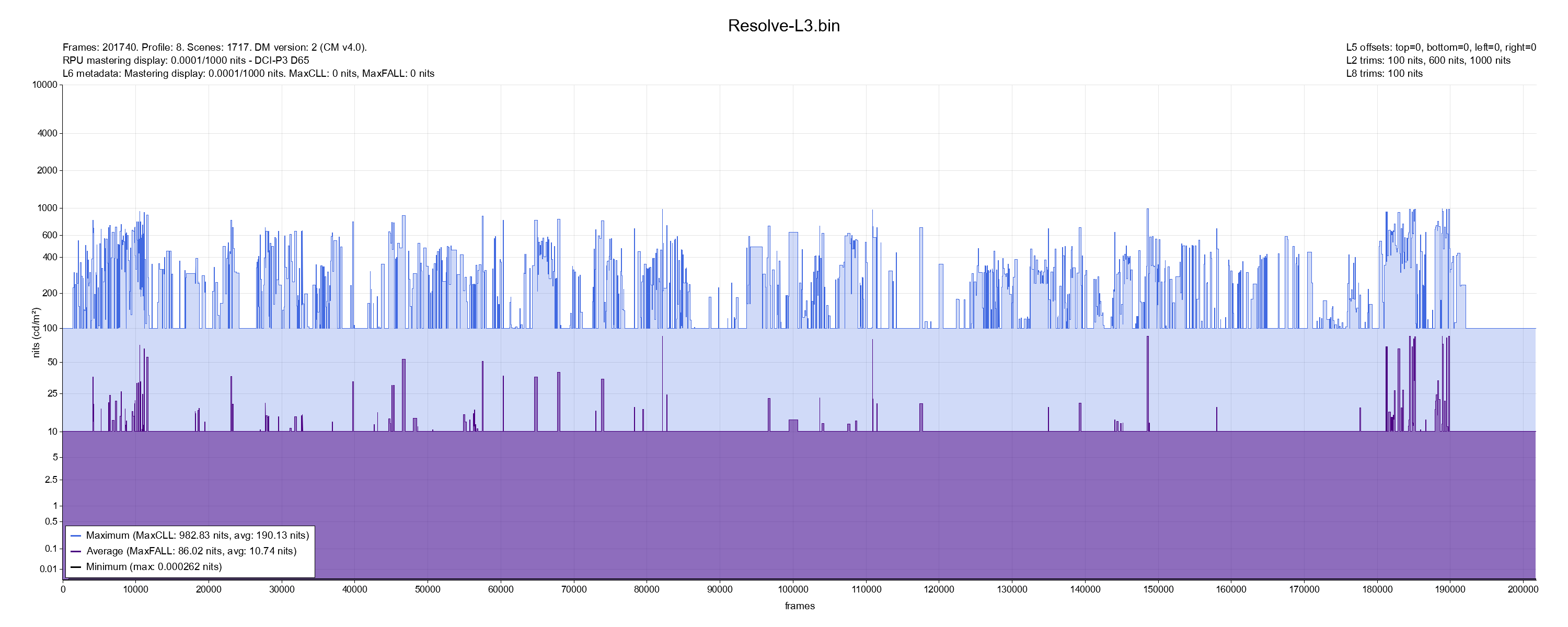

#10985 Post by bbeny123 » Mon May 26, 2025 10:23 am
@RESET_9999, I have questions regarding HDR to Dolby Vision conversion and proxy encoding.
1. cm_analyze vs. Resolve for DV conversion: which produces better (more accurate) RPU?
I've generated RPU XML files using both DaVinci Resolve (following your tutorial) and cm_analyze, and noticed differences in the Level 1 metadata. The ColorEncoding sections also differ significantly:
Resolve output:
<ColorEncoding>
  <Primaries>
    <Red>0.68 0.32</Red>

cm_analyze output:
<ColorEncoding>
  <Primaries>
    <Red>0.708 0.292</Red>
    <Green>0.17 0.797</Green>
    <Blue>0.131 0.046</Blue>
  </Primaries>
  <ColorSpace>ycbcr_bt2020</ColorSpace>
  <SignalRange>video</SignalRange>
</ColorEncoding>
Based on this and the plots below, which RPU would you consider more accurate or "better"? I've included XMLs for reference.

Posts: 2416
#10986 Post by RESET_9999 » Mon May 26, 2025 5:50 pm
I dont think the difference is big enough to have a noticeable difference in playback but if I had to guess, I would say CM might be more accurate because other things can interfere in resolve.
FYI, I did new and better test file for L1 and it seems that the average_pq has no effect at all in cmv4.0, not even high values way above my TV ABL. DV dims the image only when L1 max_pq reaches your TV target.
In cmv2.9, a 150nits max/avg_pq dims the image even on my 2500nits G5, which doesn't make much sense since the TV can do 2500 peak / 400nits full field, and this is exactly why the generated L2 trims brightens the image so much in 2.9. see: https://docs.google.com/spreadsheets/d/ ... 1289366200
So I'm no longer watching 2.9 retail movies. CMv4.0 for everything!
As for the XML header primaries, unless you encode in DEE, it doesn't matter.
As for the ProRes profile, as long as the brightness and colors remain the same, I don't think it matters much.
PS: The CM warning msg are gone in the latest version. It also fixed my Windows 11 crashes.
