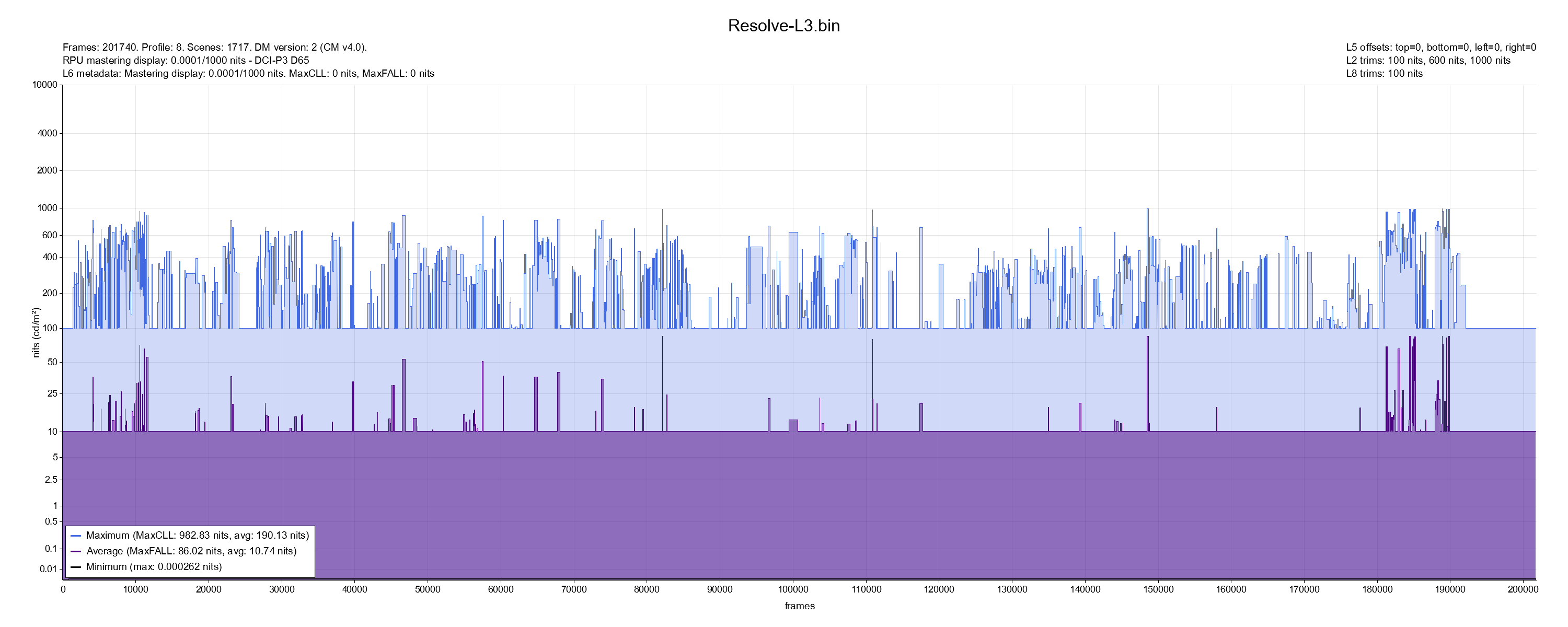

@RESET_9999, I have questions regarding HDR to Dolby Vision conversion and proxy encoding.
1. cm_analyze vs. Resolve for DV conversion: which produces better (more accurate) RPU?
I've generated RPU XML files using both DaVinci Resolve (following your tutorial) and cm_analyze, and noticed differences in the Level 1 metadata. The ColorEncoding sections also differ significantly:
Resolve output:

Based on this and the plots below, which RPU would you consider more accurate or "better"? I've included XMLs for reference.

Posts: 2392
Post by RESET_9999 » Mon May 26, 2025 5:50 pm
I dont think the difference is big enough to have a noticeable difference in playback but if I had to guess, I would say CM might be more accurate because other things can interfere in resolve.
