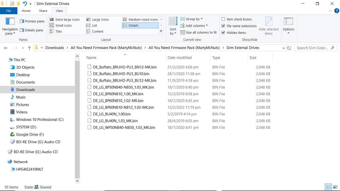

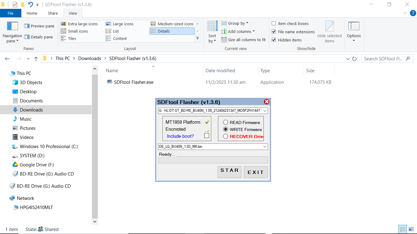

Hi guys,
Just bought myself 2 Verbatim 43888 and is now at the crucial stage of flashing them to make them able to rip 4K Blurays as well as playable with all video player softwares without bricking the drives. All the details are in the screenshots and without having to carry on reading pages and pages of info on the intricacies of this flashing, in other words the shortcut, I just will ask a few questions and hopefully I'm straight away on my way to ripping and be done with. Of course, reading the rest when I have the time to do so. The screenshots show what I have done and getting myself ready before pressing the START buttton. Please confirm what I have inputted in the flasher are correct.
Questions
(1) Does the flasher auto detect it's an encrypted firmware like the LG 1.05 and so we don't need to do anymore things like stating it's encrypted?
(2) What's the purpose of the READ in the flasher when it's basically WRITE that's most will be interested in?
(3) RECOVERY Mode? Purpose? Wow, sounds like we can brick the drive and have to take extra precautions.
(4) What's the purpose of having LG BU40N version 1.00 and 1.03 MK? I thought the larger number version will always have the least bugs?
Await your clarifications on these questions before pressing the flasher START button. Thanks everybody here for the hard work done for us to use successfully.

Post by MartyMcNuts » Fri May 16, 2025 12:23 am
XTRProf wrote: Thu May 15, 2025 10:08 am Hi guys,
Questions
Chong
PS: The last screenshot will be next as cannot attached more than 3 screenshots here.
1. yes
2. It allows you to save the important cal data from the drive
3. pretty hard to brick a drive. more used for silly people that manage to flash older, incompatible drives and also to cross-flash the BP50/WP50NB40
4. MK firmware generally only works with MAkeMKV and xreveal. The firmware's generally don't have bugs and version changes usually only offer disc writing updates. As far as ripping UHD is concerned, newer firmware is usually not better!
You should flash the drive with BU40N 1.03-MK first. You can leave it there or if you want to use a wider range of software, you can now flash it to BU40N 1.00 firmware.
XTRProf
Joined: Sun Dec 20, 2020 8:12 am
Re: SDFtool Flasher
Post by XTRProf » Fri May 16, 2025 6:29 am
Thanks Marty for the confirmation. After your authentication, now to go "nuclear" START at version 1.03 MK first. Target Verbatim 43888 coordinates. Heh, heh, heh ......... :lol:

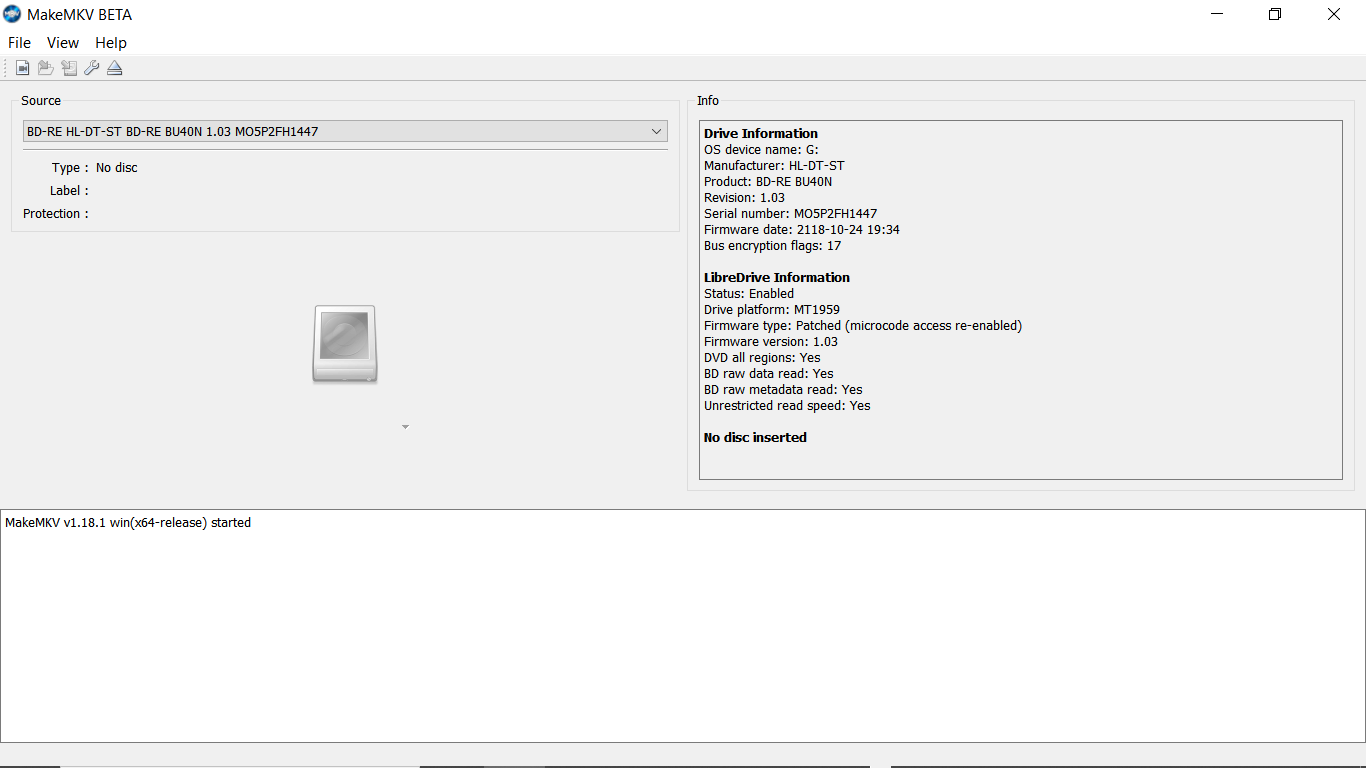

XTRProf
Re: SDFtool Flasher
Post by XTRProf » Fri May 16, 2025 6:50 am
So very very happy!
Thanks very much, Marty. Cheerio!
Chong

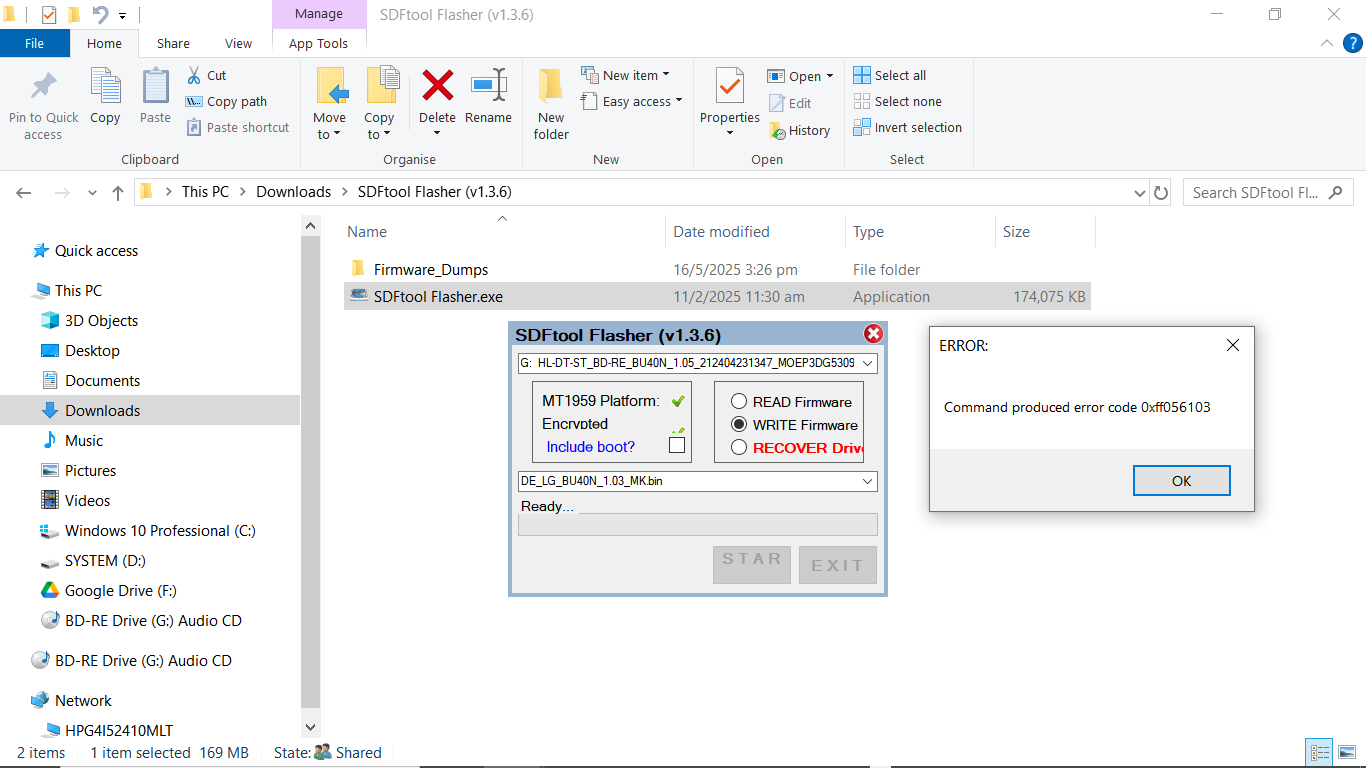

Sorry. Try to flash my second Verbatim 43888 but there is an error code message. How come?
Thanks.
Chong
