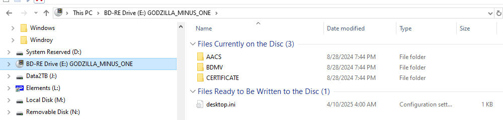

GODz drive info.jpg (42.82 KiB) Viewed 17062 times

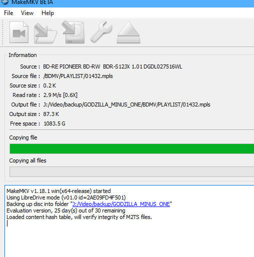

#1310 Post by KAIJUKACZ25 » Sat May 03, 2025 2:20 pm
I had to "Capture" this, and within seconds (saying it is copying, and after it Decrypts..) I get the BSoD, and the computer restarts. On the full screen, if You can't see, it says Elapsed 10sec. and on the bottom bar, 22sec

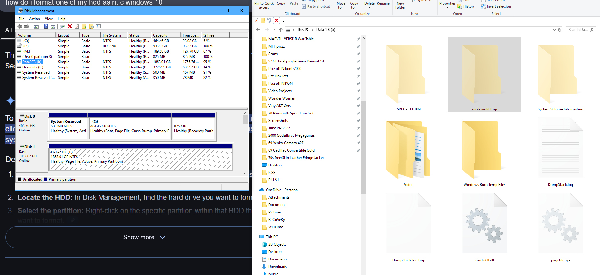

I killed All that is on my "J:" drive, and looks to already be formatted as NTFC (would I still need to Format?), so What/Why am I Still getting the BSOD this time, when I opened up MKV, it completed the Decrypt/Copying, and as soon as I tagged the MakeMKV button, screen went all 'KaBLUEy' on me!?
H E L P > >
J drive is NTFC.jpg (652.58 KiB) Viewed 17012 times

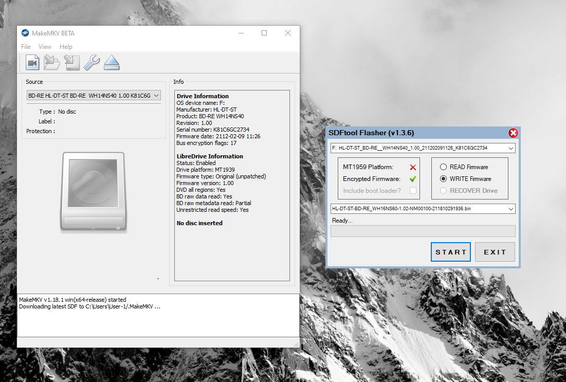

KRIS_DETH
Joined: Fri May 09, 2025 9:46 am
Re: SDFtool Flasher
#1319 Post by KRIS_DETH » Fri May 09, 2025 9:49 am
Hi all,
Hoping that I can pick someones brain as I've just purchased an LG WH14NS40 - checked on MakeMKV that it's MT1939 which it is, but when using the tool, it states that it isn't a MT1939 platform, see screenshot below, any ideas on the best way to get around this to get the correct firmware on it?
Drive Info.png (445.21 KiB) Viewed 15794 times
Any help will be greatly helpful!
Posts: 4544
Re: SDFtool Flasher
#1320 Post by dcoke22 » Fri May 09, 2025 11:51 am
KRIS_DETH wrote: Fri May 09, 2025 9:49 am Hi all,
If you look at the Ultimate UHD Drives Flashing Guide you'll notice right at the top is says your drive platform needs to be MT1959. SDFtool Flasher isn't flashing your drive because it is NOT the MT1959 platform; it is saving your from yourself. If you do flash your drive, you'll brick it and it'll be unusable.
