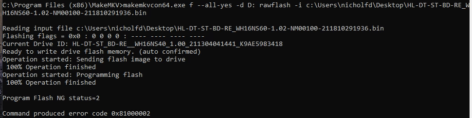

I thought I would be able to flash it to read UHD discs & tried with this:
C:\Program Files (x86)\MakeMKV\makemkvcon64.exe f --all-yes -d E: rawflash -i c:\Users\nicholfd\Desktop\HL-DT-ST-BD-RE_WH16NS60-1.02-NM00100-211810291936. bin
No drive tool logic found in SDF.bin
Internal error 0x8d000000
-------- PROGRESS --------
Wrong drive letter in the flash command (I know - details matter). Tried again. Did something, but eventually failed (after long delay):
Drive Flash Failure.png (173.52 KiB) Viewed 18215 times
Shutdown, removed power, reapplied power & turned back on. MakeMKV now shows:
Drive Info After Failed Flash.png (29.13 KiB) Viewed 18215 times
Have I FUBAR'd this drive? I still have the 2nd one...

Posts: 5793

do not flash it

Thanks - too late. I found an issue & tried again. Thought I made progress. I updated my original message before you posted this one or they crossed. Is it hosed?
dead unless you have a pc with sata ide mode and a 32bit os
see recovery section in guide
i no longer give out kits for these was way to much trouble as know one tells the truth about their pcs
Thanks - the PC I moved the drive to is a "utility" PC, and to flash the drive I installed fresh Windows 10 64-bit (left unlicensed). I have a MSDN subscription & it looks like the 32-bit version of Windows 10 is still available (downloading now). What do I need to look for/at in the BIOS, or what information can I share to find out if the motherboard supports "SATA IDE mode"? I'm not sure I've ever heard of that.
Looking for the recover guide section now...
Or, is this drive not worth trying to recover (your time - I don't mind wasting my time playing with it)? I only wanted to mess with it as a backup for UHD discs. If it can be recovered & flashed to read UHD discs, I'm glad to make a PayPal donation. I'm sure I used it many years ago for DVD/BR. I probably abandoned it when/if it could not manage UHD (at the time). The Mac Pro it's been in has been out of use for probably 10 years...

follow the recovery section and my dosflash video do the recovery stuff first make sure to do the steps exactly or dos flash wont work
as i said i dont do kits for this anymore more time than its worth everything you need is in the guide and my old dosflash video from 2019
