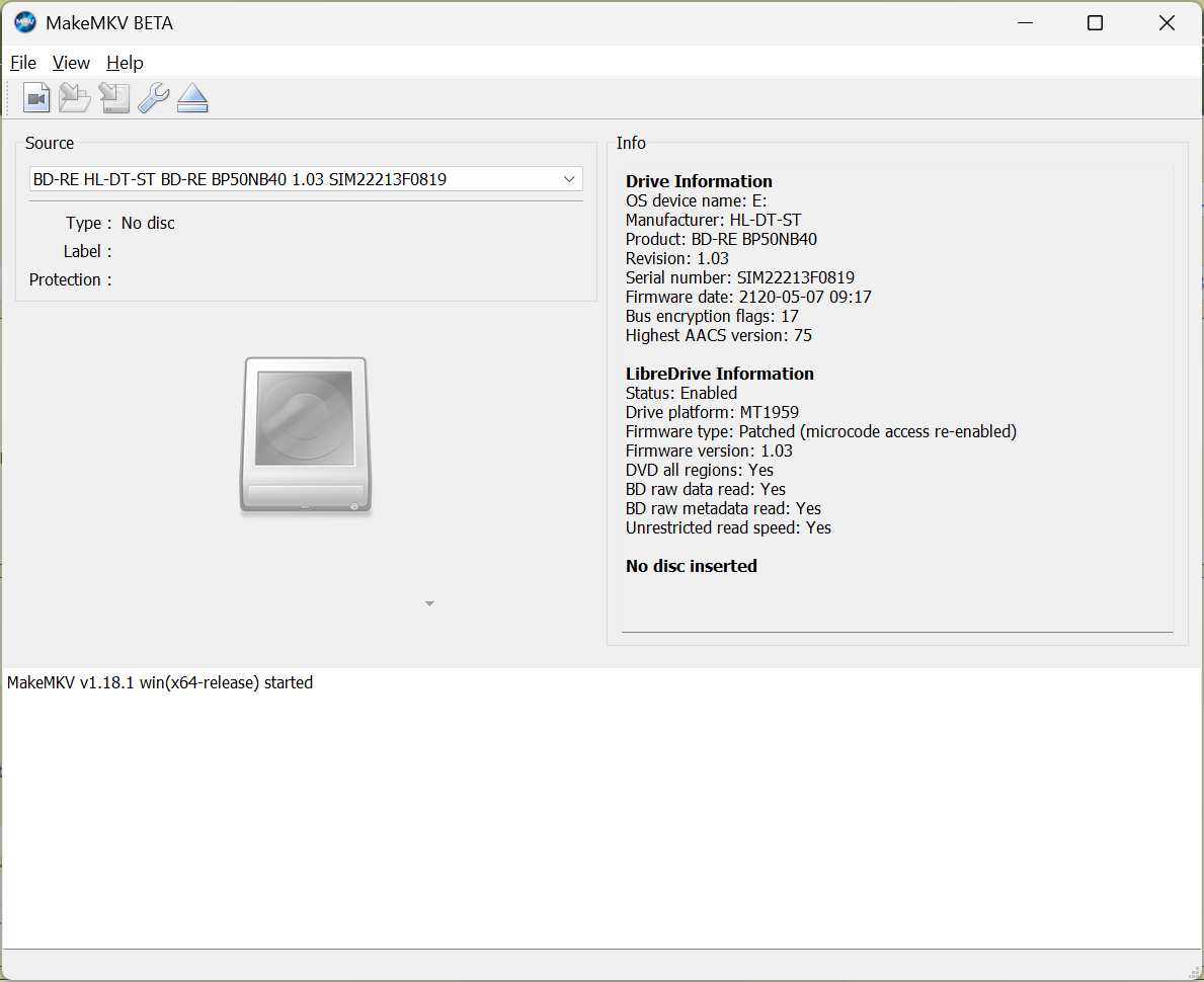

I have a LG slim portable drive BP50NB40 SVC NB52 drive and I was able to use your tool and follow your 4 step instructions with the tool all reporting success. However, when I inserted a UHD disc into the drive it failed to recognize the disc with MakeMKV 1.81.1 and have this repeated spin up and then stop sound.
I tried resetting the PC and also un-attaching and re-attaching the drive, but still get the same result. Attached is a screen shot of my drive info in the MakeMKV. I am wondering can you provide some guidance?

Umm.... You haven't completed the process. You have only done half as your drive is still on BP50NB40 1.03 MK firmware. You need to perform the reovery steps now to get the drive cross-flashed. Follow the gif!!stateWideBread wrote: Mon Apr 28, 2025 5:08 am Hi MartyMcNuts,

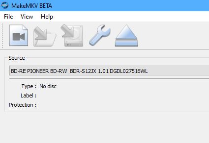

I didn't know if this was necessary, but, here it is anyway..
Thanks for helping me MM!
Krazy Kacz

I believe this drive should be BDXL and UHD capable as is. Please try a UHD disc. Also, in MakeMKV go to view/preferences and under the General tab, be sure that the "Enable Internet access" checkbox is checked as internet access is required so MakeMKV can download the latest UHD hashed keys database.KAIJUKACZ25 wrote: Fri May 02, 2025 3:20 pm Got It:
OS device name: E:
Manufacturer: PIONEER
Product: BD-RW BDR-S12JX
Revision: 1.01
Serial number: ,,,
Firmware date: 2020-07-21
Highest AACS version: 77
Drive platform: RS8F01
Firmware version: 1.01/ID72
