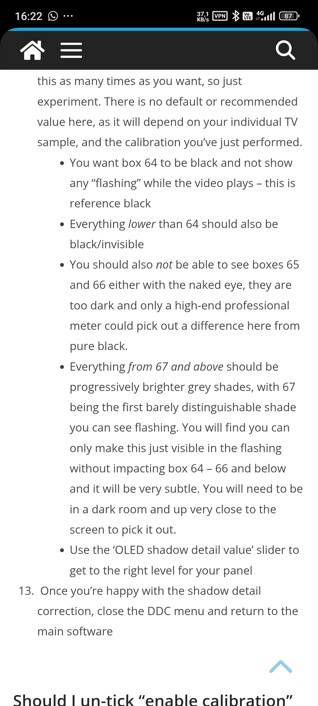

If I'm not mistaken, you should see 66–67 flashing from a normal distance, and 65 only when looking about one foot away from the screen. Of course, all of this is in a dark room without lights.
Wrong.
Bar 64 is reference black. Bar 64 and everything below it should be black. Bar 65 and 66 should also be impossible to see it flashing. The first visible bar should be 67. But barely with your nose on the screen. This is all written down in the Calman calibration guide you can find on the Internet.
LG OLED65G1RLA / Samsung HW-Q990D / Sony UBP-X800M2 / Ugoos AM6B+ (CE with CPM Build)

Thanks daffie! That explains why I had to raise my black level (above 50) on my LG C2 to get 65-66 to be visible and flash in a dark room, but it didn't make sense intuitively that this would be needed (and some movies looked like blacks were raised as a result). Appreciate the sourced info. :)
Do these rules apply to all SDR, HDR10 and DV? Because from the TVs I own, it seems HDR10 & DV always crush black more than SDR.

@deadchip12
Yes, the rules are the same for SDR, HDR and DoVi.
