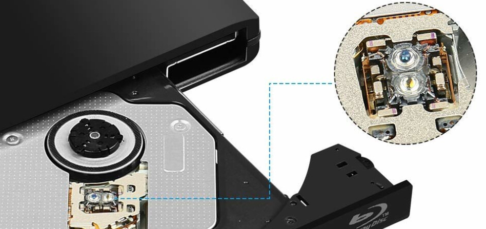

Clean the laser with q-tip and alcohol. Dry immediately with a lint-free soft cloth or a dry q-tip. Do it twice.
The BDR-XD05 is an USB drive, so you don't have to open the enclosure, the laser lenses you can find there like you can see in the attachment (another drive but a good example).

Thank you for that information! I will give that a shot and report on how it goes.zittrig wrote: Mon Mar 31, 2025 6:19 am Clean the laser with q-tip and alcohol. Dry immediately with a lint-free soft cloth or a dry q-tip. Do it twice.

I finally had a chance to try this but I still can't get the drive to read any disc. The discs don't even spin in the drive. The drive powers on but no disc will spin and nothing is being read. Is the drive just a dud?zittrig wrote: Mon Mar 31, 2025 6:19 am Clean the laser with q-tip and alcohol. Dry immediately with a lint-free soft cloth or a dry q-tip. Do it twice.

Sounds like it's dead.Shermin3656 wrote: Sat Apr 05, 2025 1:22 amI finally had a chance to try this but I still can't get the drive to read any disc. The discs don't even spin in the drive. The drive powers on but no disc will spin and nothing is being read. Is the drive just a dud?zittrig wrote: Mon Mar 31, 2025 6:19 am Clean the laser with q-tip and alcohol. Dry immediately with a lint-free soft cloth or a dry q-tip. Do it twice.
