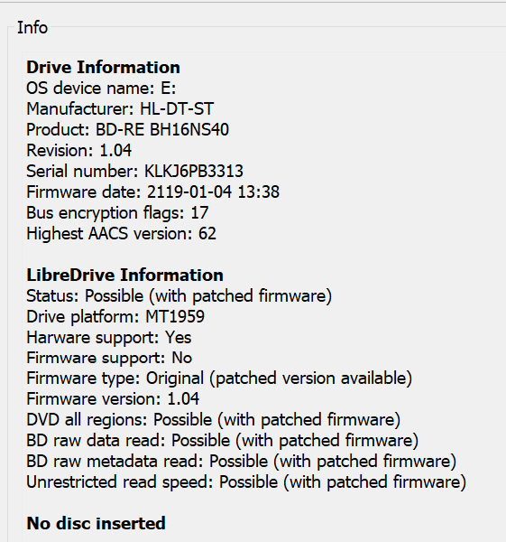

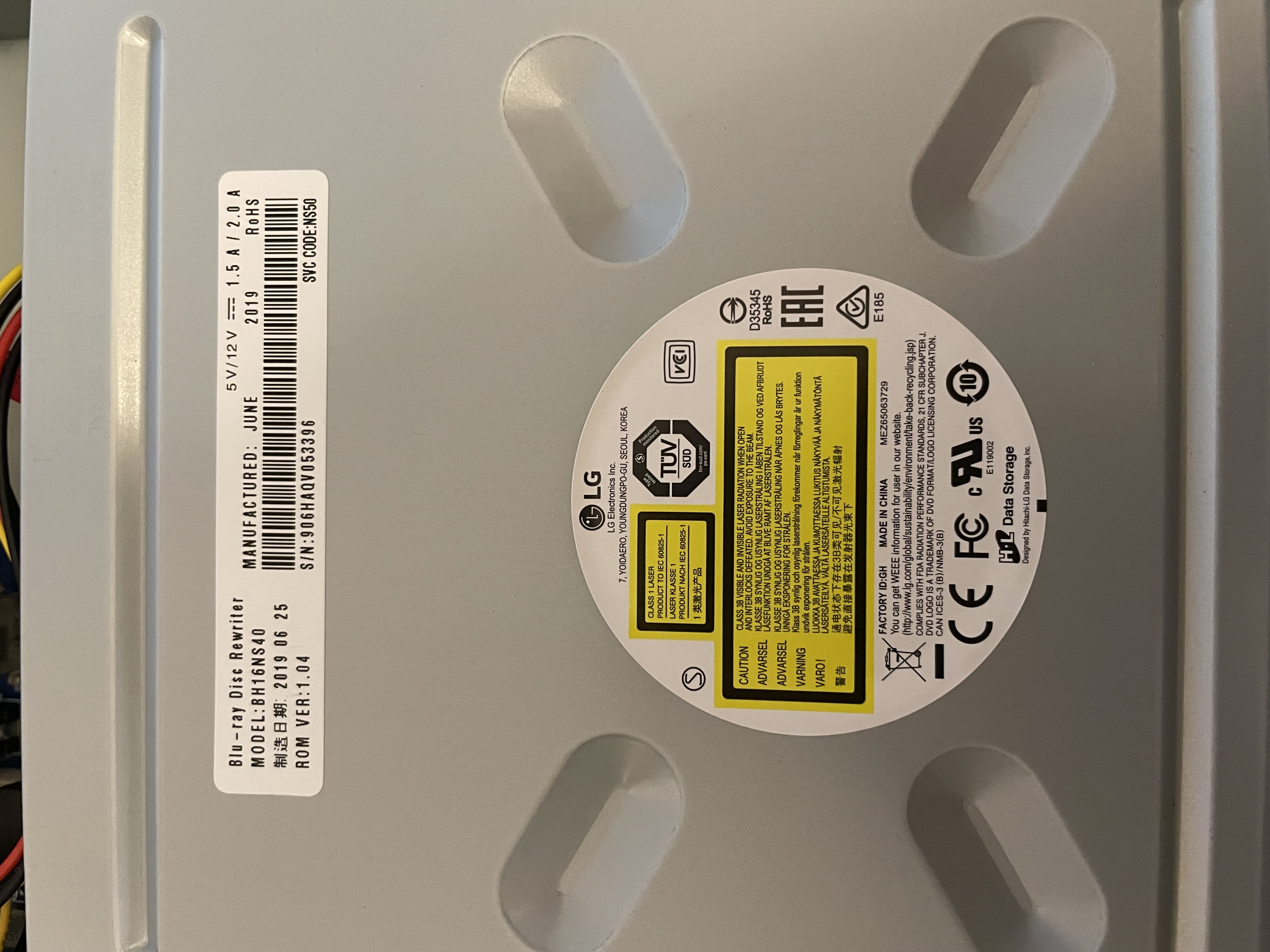

plantboy
Joined: Wed Sep 26, 2012 8:01 pm
Re: SDFtool Flasher
Post by plantboy » Sat Mar 29, 2025 12:23 am
MODEL: BH16NS40
SVC CODE: NS50
ROM VER: 1.04
Manufactured: June 2019
See attached photos. I've spent a few hours reading the information here, but I'm hung up on "WH16" vs. "BH16", unsure if any of the firmware packs have what I need.
I'd really appreciate guidance.
I've already made a firmware backup via the SDFtool Flasher.exe, and the backup was named like this:
dump_user_HL-DT-ST_BD-RE__BH16NS40_1.04_211901041338_KLKJ6PB3313.tar
Posts: 1716
Re: SDFtool Flasher
Post by d00zah » Sat Mar 29, 2025 12:26 am
plantboy wrote: Sat Mar 29, 2025 12:23 am MODEL: BH16NS40
SVC CODE: NS50
ROM VER: 1.04
Same hardware. "WH16" vs. "BH16" denotes OEM vs retail (or vice versa?).
Posts: 4920
Re: SDFtool Flasher
Post by MartyMcNuts » Sat Mar 29, 2025 4:16 am
SVC CODE: NS50
ROM VER: 1.04
That backup is only the important cal data. It's not a full firmware backup.
The recommended firmware for your drive is WH16NS60 1.02-MK.
