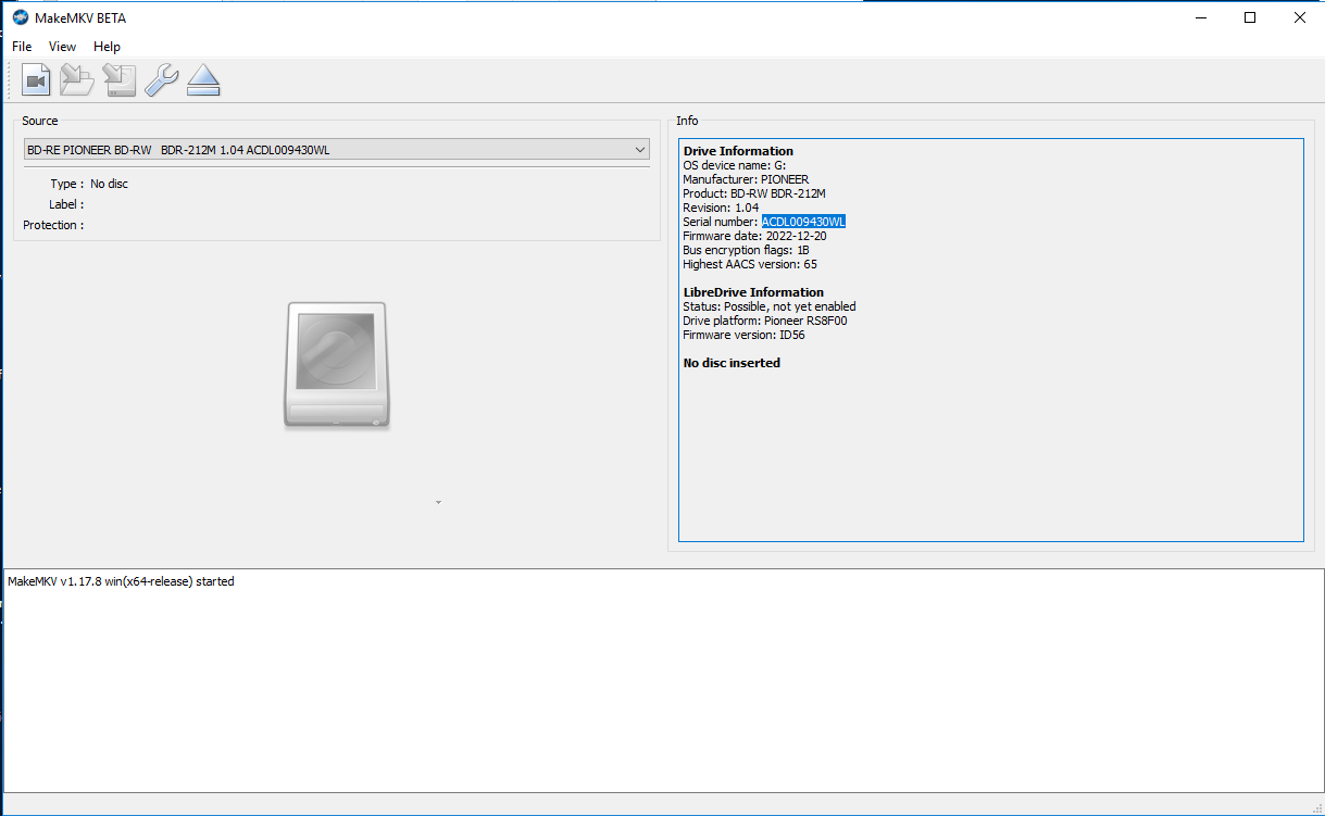

Hi, sorry to jump on the back of this thread but I am also having issues with my drive even seeing a 4k Ultra UHD disc. This is with the latest download of MakeMKV and others.
I can only see the model as "212-M" and can't see anything more detailed (unless of course I take the drive out of the case). If I have to then that is the case ;-)
My driver is showing as
Can this be updated? Going to Pioneer site there are several 212 with different codes but none that just say 212-M.
Or is it time to buy a newer BDXL Drive

nah sorry to new man need to be from before 12/22

ok, so basically no new drives will recognise or play 4k UHD even though they are described as doing so?
Is it possible to drop the firmware or flash it to a lower version so that it does read it?
Kind of crazy that drives are now effectively useless. I am guessing that this is some sort of deliberate protection, but again, what is the point of the drive being BDXL if it still will not read them.
I wanted to get this on to Plex, but even without that, if I can't play them, not sure why the discs are even produced.
I have seen some other posts about your software that can flash/downgrade? Does this include support for this drive?

they see 4K discs just fine play them back too but only if you have an official sgx setup
makemkv cant do anything with the new fw thats all
again it will read them but you cant rip or copy them you have to remember ripping is an exploit your only supposed to play them in their eyes
legally encrypted backups are fine but its more gray when you decrypt it
only if the fw is older than 12/22
i have some with old fw still if you want one see below and email me
