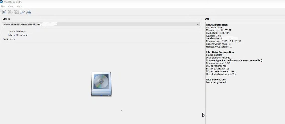

I now got the disc to load for about 1 seconds. It now says it supports AACS 77, but no matter what I try I can't get a disc to load that is above 68. See screenshot it says it supports it but spins then says no disc.
- Screenshot_20250303-180837.png (163.72 KiB) Viewed 12547 times

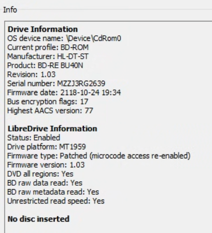

This is what I get loading then no disc unless it's AACS 68 then it loads after 20-30 seconds no errors.

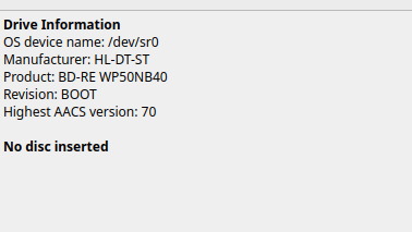

So I'm pretty sure my WP50NB40 is a paperweight but I just wanted to check if anyone had any ideas on if this can be fixed.
I flashed the MK 1.02 build which it showed on MakeMKV and then I proceeded to do the cross flash to BU40N. In a moment of monumentally poor judgement I unplugged the drive when I mistakenly thought it was finished flashing. Now the drive reports its Revision as BOOT does not respond to the button press and the flasher GUI reports it is not an MT1959 and makemkv flasher just sits there.
I tried creating the bootable USB for the DOS flasher but it does not boot so I have not been able to try that yet.

flash it with the official LG updater sometimes they can unbrick itgunslingerfry wrote: Tue Mar 04, 2025 1:53 am So I'm pretty sure my WP50NB40 is a paperweight but I just wanted to check if anyone had any ideas on if this can be fixed.

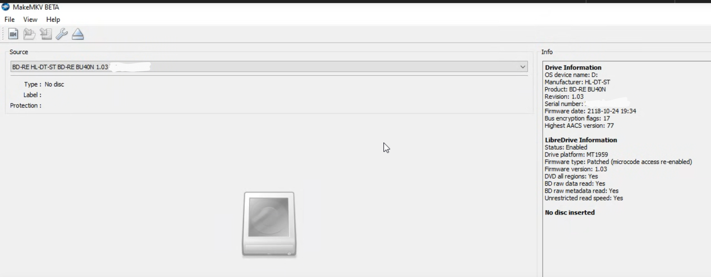

I get it to load the disc and then it just says no disc?
It loads the disc and then nothing it spins forever to fail

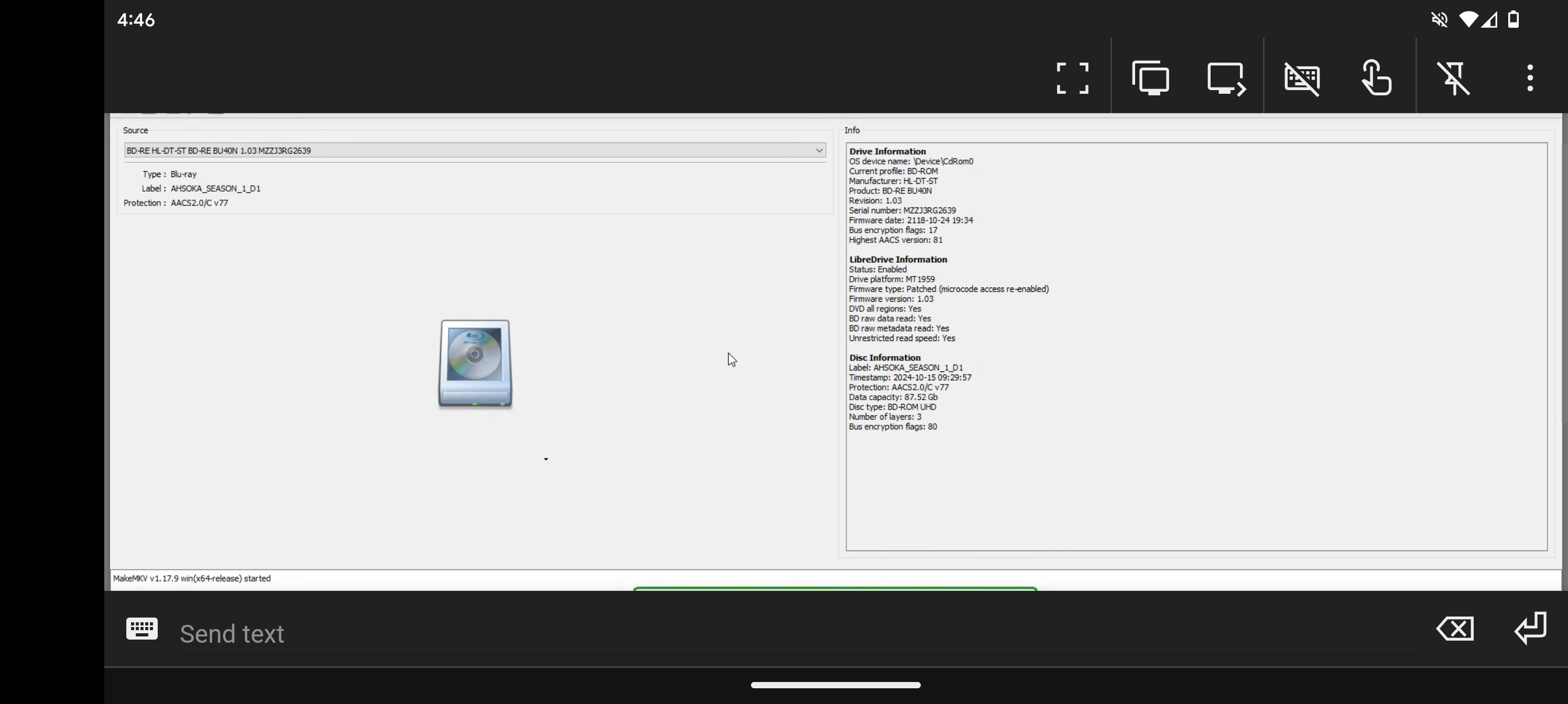

- Screenshot_20250304-164636.png (434.7 KiB) Viewed 12222 times
You could try gently cleaning the disc.

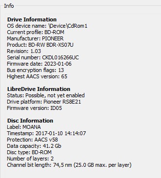

I have this BDR-XS07U that I got because it was on the list of Pioneer drives here. I've had about 50% success rate with it out of 10 BDs. Would a firmware update be helpful?
- make_mkv_bd.jpg (36.3 KiB) Viewed 12126 times

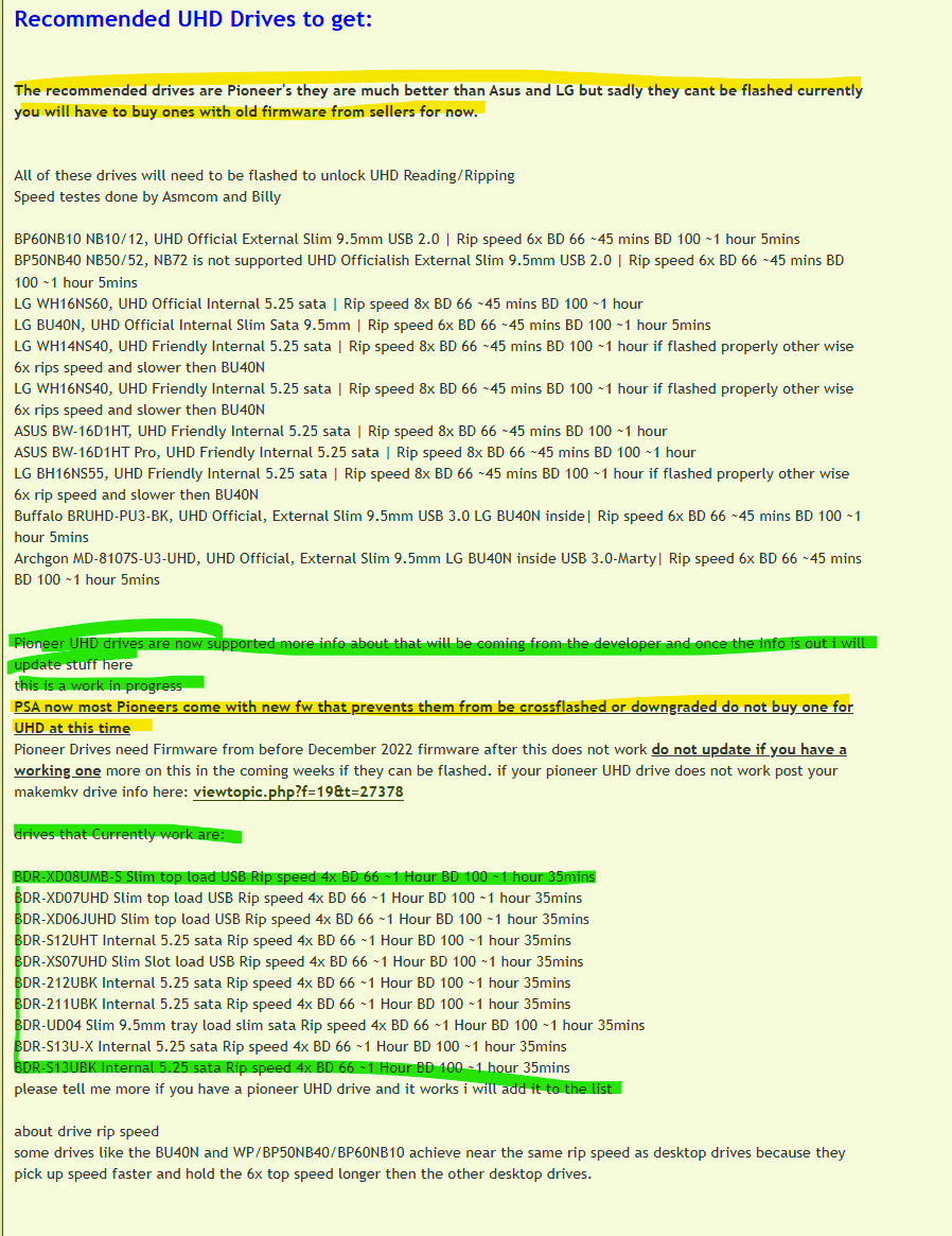

Did you read about recent Pioneer firmware updates preventing the drives from being LibreDrive compatible and therefore unable to rip 4K UHDs?bohmchri@isu.edu wrote: Wed Mar 05, 2025 6:11 am Hey, thank you for the list of drives here. I've referred to it so very often in the past weeks while tryin to purchase the correct pioneer BD drive. You all are awesome!
I'm so confused by the pioneer drives. I want to buy one to see if it helps with some disks that are giving me io errors. However there are multiple conflicting statements, even in this main thread. What is the current status with Pioneer drives? Are the green highlights (pioneer works, w/ drive list) accurate, or the yellow highlights accurate / must buy from re-seller?
- Posts: 6011
the yellow you need one from a seller unless you fine one with fw before 12/22TylerS wrote: Fri Mar 07, 2025 3:57 am I'm so confused by the pioneer drives. I want to buy one to see if it helps with some disks that are giving me io errors. However there are multiple conflicting statements, even in this main thread. What is the current status with Pioneer drives? Are the green highlights (pioneer works, w/ drive list) accurate, or the yellow highlights accurate / must buy from re-seller?
gunslingerfry
- Posts: 4
- Joined: Mon Mar 03, 2025 7:46 pm
No dice. It also recognizes it and marks the rev as BOOT but I immediately get a WRITE DRAM NG 05/26/03. Thank you!Billycar11 wrote: Tue Mar 04, 2025 3:09 amflash it with the official LG updater sometimes they can unbrick itgunslingerfry wrote: Tue Mar 04, 2025 1:53 am So I'm pretty sure my WP50NB40 is a paperweight but I just wanted to check if anyone had any ideas on if this can be fixed.
