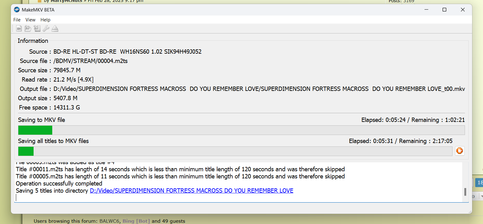

4K Rip.png (90.43 KiB) Viewed 12061 times
It worked the drive was manufactured in 2017 and I did the GUI based tool and the Google Drive link for the firmware packs. In the screenshot you can see I'm doing a rip of the 4K version of Macross Do You Remember Love I just got in today. I'm happy that Iucked out with already having the drive. Looking forward to being able to rip Ultra HD Blu Rays!!!

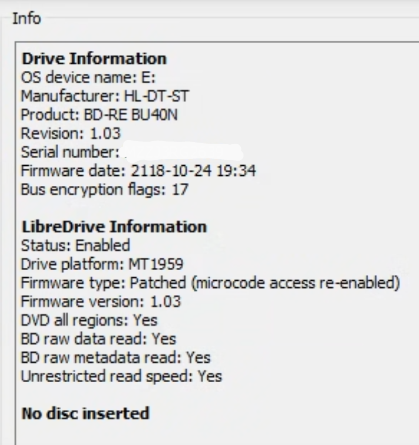

I have makemkv 1.17.9.
I have BU40N running 1.03 mk firmware
I can only run UHD discs up to AACS 68
I have several that are AACS 77 how do I get them to register with my drive if I load anything above 68 it says no disc after it spins up and down.
If I load a 68 or below in about 20-30 seconds it loads right up see photo and I can make a copy with no issues.
What do I need to do from here to get the key database updated to accept AACS 77?
