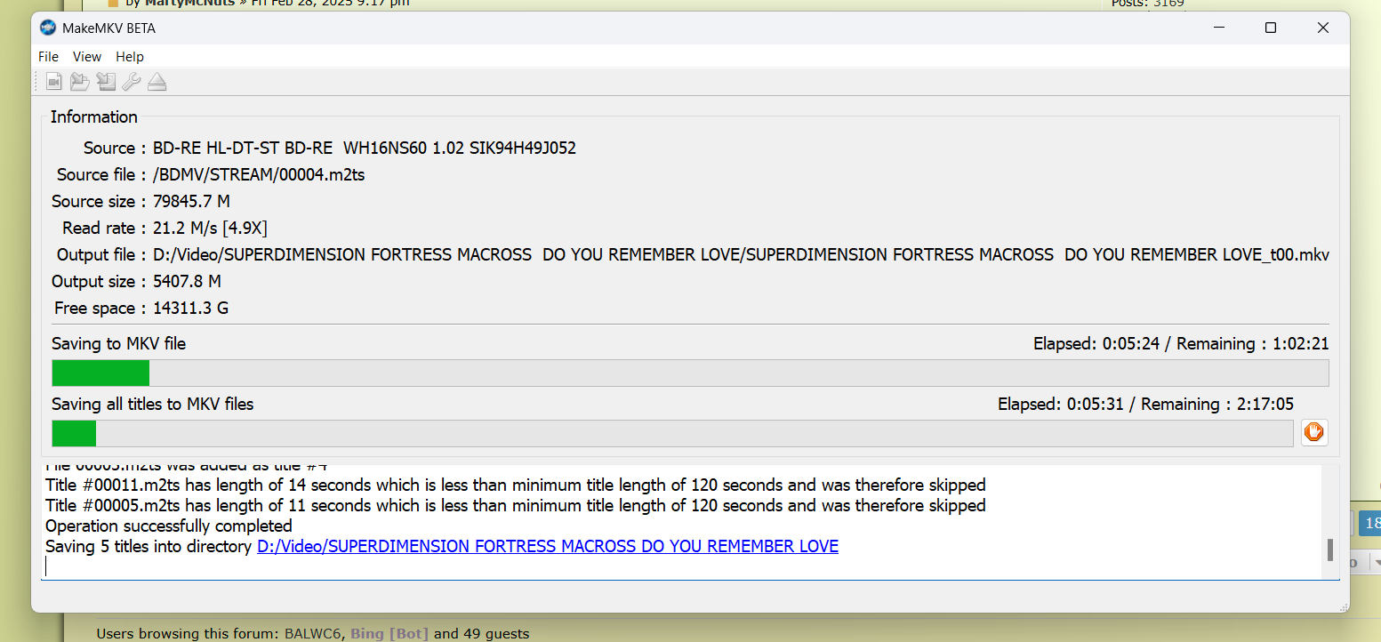

#2781 Post by BALWC6 » Sat Mar 01, 2025 3:29 am
MartyMcNuts wrote: Sat Mar 01, 2025 3:17 am
BALWC6 wrote: Sat Mar 01, 2025 3:11 am
BALWC6 wrote: Fri Feb 28, 2025 10:29 pm Looking to get a Blu-Ray writer that can do 4K, I currently have a Samsung SE-506CB/RSBD and I wasn't sure if it is 4K capable. The drives I'm looking at are below:
LG Electronics BP60NB10: https://a.co/d/dKhFKgh
Pioneer BDR-XD08UMB-S: https://a.co/d/iDUI0VH
I've done the reading on the Pioneer drives don't work, but I do prefer them in terms of looks and quality. Any advice is appreciated!
Turns out my Plex Media Server tower has a drive already in there. I have an LG WH16NS40 drive. So going to attempt the flashing of the firmware from the guide.
Just make sure the WH16NS40 is manufactured after October 2015, has the SVC NS50 code on the sticker and has the MT1959 drive platform BEFORE ATTEMPTING TO FLASH IT!!
4K Rip.png (90.43 KiB) Viewed 13095 times
It worked the drive was manufactured in 2017 and I did the GUI based tool and the Google Drive link for the firmware packs. In the screenshot you can see I'm doing a rip of the 4K version of Macross Do You Remember Love I just got in today. I'm happy that Iucked out with already having the drive. Looking forward to being able to rip Ultra HD Blu Rays!!!

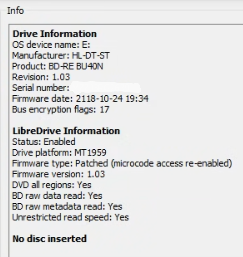

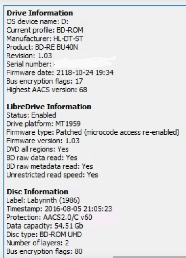

#2790 Post by mm13579 » Mon Mar 03, 2025 10:55 pm
I have makemkv 1.17.9.
I have BU40N running 1.03 mk firmware
I can only run UHD discs up to AACS 68
I have several that are AACS 77 how do I get them to register with my drive if I load anything above 68 it says no disc after it spins up and down.
If I load a 68 or below in about 20-30 seconds it loads right up see photo and I can make a copy with no issues.
What do I need to do from here to get the key database updated to accept AACS 77?
