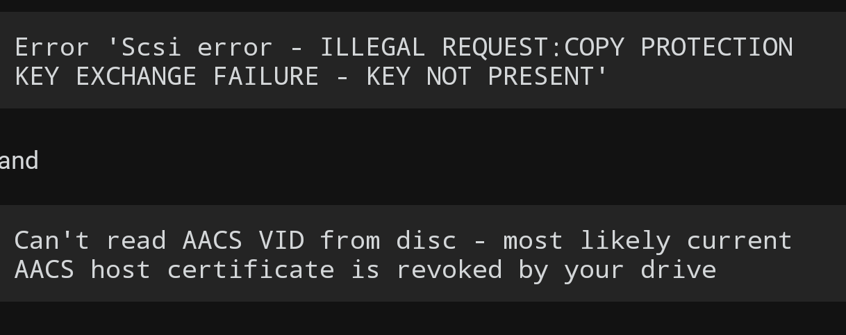

So I managed to test 1.02 and 1.03mk firmware with my BU40N drive and can get it to show the UHD disc now but when I click it it runs and gets error see screenshot. It does not make any sense. But it does DVD and Blu ray just fine it is just messed up for UHD discs

I wanted to mention as previously stated it is running LibreDrive and it is unrestricted with settings displayed and I'm using makemkv 1.7.8 and 1.7.9 version with no difference

post your makemkv drive info sectionmm13579 wrote: Fri Feb 28, 2025 2:20 am So I managed to test 1.02 and 1.03mk firmware with my BU40N drive and can get it to show the UHD disc now but when I click it it runs and gets error see screenshot. It does not make any sense. But it does DVD and Blu ray just fine it is just messed up for UHD discs
Here it is with 1.03 MK Firmware
