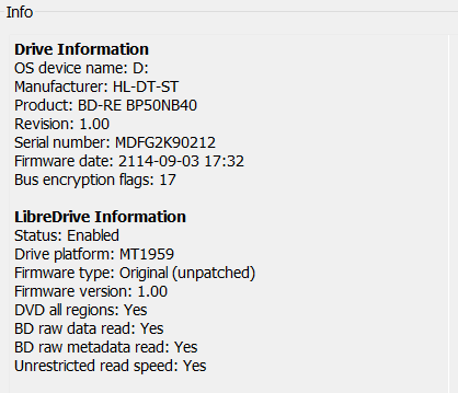

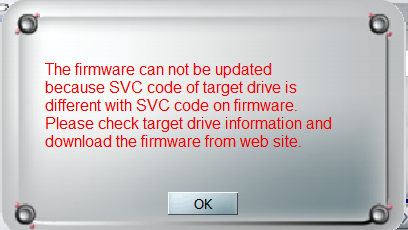

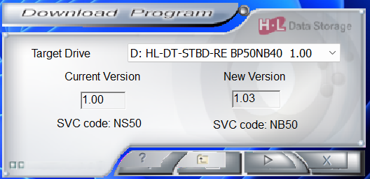

geminikanon
Joined: Fri Feb 14, 2025 6:52 am
Re: SDFtool Flasher
Post by geminikanon »
How can I make that my unit read UHD discs? I have already followed the steps as indicated in the guide.
the flashing is done and the firmware is changed but the unit is left in a state where the tray does not open,
I must restore it with the firmware BP50NB40-NB40-1.00-Clean.bin to make it work again.
I try to update with the official application, it show a message that the SVC code is different and does not allow me.
Any help or suggestions would be greatly appreciated.

Posts: 4991
Re: SDFtool Flasher
geminikanon wrote: Sat Feb 15, 2025 7:31 am How can I make that my unit read UHD discs? I have already followed the steps as indicated in the guide.
Why are you using that old flasher from years ago?? I'm not sure what instructions you are following but they must be very old for yhou to be using that.
Why not follow the instrucitons in the first post of this very thread??
