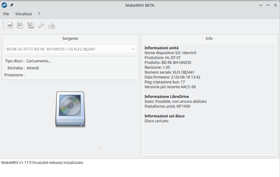

Hi all,
I have the same problem with MakeMKV 1.17.9 on Manjaro stable updated to today.
What I've found:
* MakeMKV starts correctly without a disk
* iserting a disk results in an infinite loop
* copyng the disk with dd creating an ISO image and giving the image as input to MakeMKV works correctly and generates the MKV files
The window with the loop
The makemkvcon info (interrupted with CTRL+C) and the log
   ~/Video  LANG=C makemkvcon info dev:0 --debug=makemkv_debug.txt                                                                                                                               ✔
MakeMKV v1.17.9 linux(x64-release) started
Debug logging enabled, log will be saved as file:///home/mirto/MakeMKV_log.txt
DEBUG: Code 0 at %!`0:r|CkMG!# EZc^amvu:29393631
^C
    ~/Video  cat /home/mirto/MakeMKV_log.txt                                                                                                                                        INT ✘  2m 1s 
Debug log started at Sun Feb 16 17:50:50 2025 , written by MakeMKV v1.17.9 linux(x64-release)
001005:0000 MakeMKV v1.17.9 linux(x64-release) started
001004:0000 Debug logging enabled, log will be saved as file:///home/mirto/MakeMKV_log.txt
Network access is ENABLED, CURL version 8.12.1/OpenSSL/3.4.0/1.64.0 (x86_64-pc-linux-gnu) , proxy server not set.
001003:0020 DEBUG: Code 0 at %!`0:r|CkMG!# EZc^amvu:29393631
No  SDF v098: HL-DT-ST_BD-RE__BH16NS55_1.05_212006181342_KLFL1BJ2441
SDF auto v098: HL-DT-ST_BD-RE__BH16NS55_1.05_212006181342_KLFL1BJ2441
    ~/Video                                                                                                                                                                                       ✔
