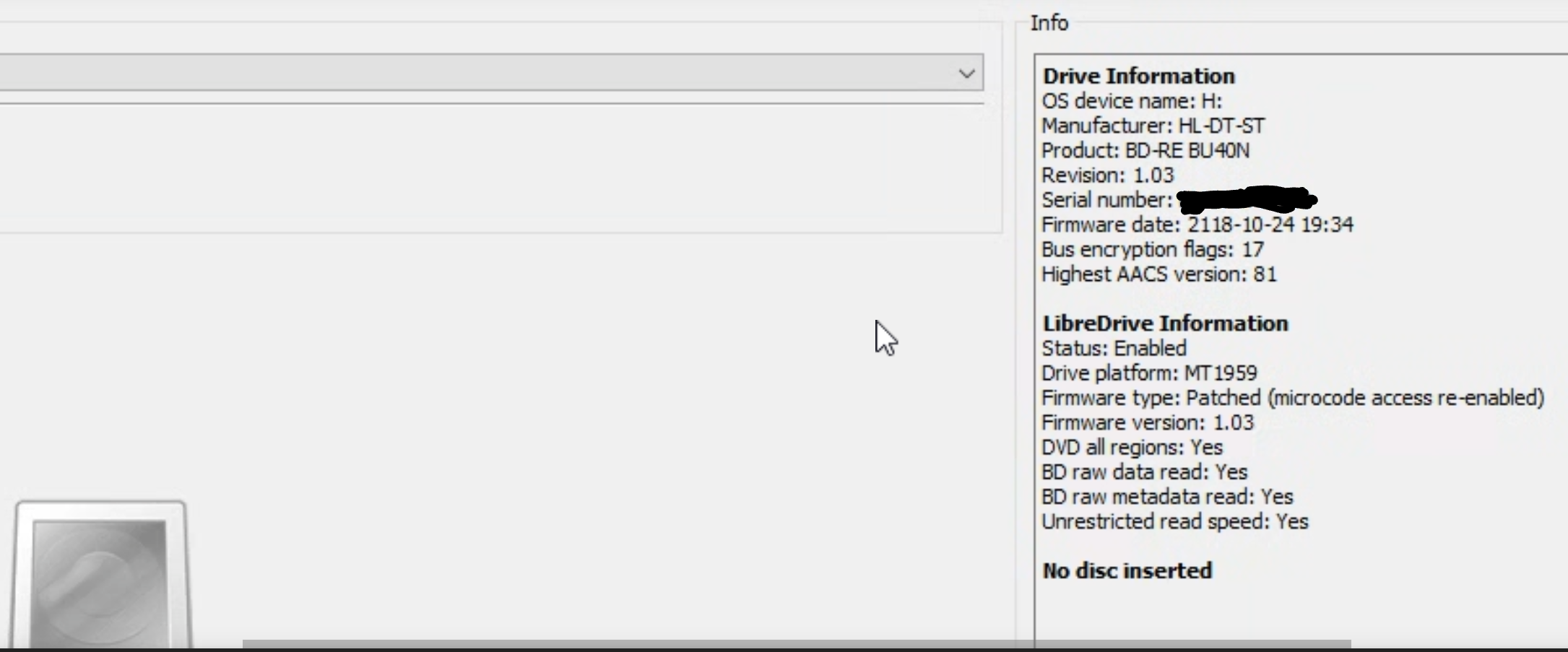

I have this setup and could not get it to read any disc. It said loading then said no disc in drive. I updated firmware as seen in attachment. It now does Blu ray, but it still won't find a UHD disc and I tried several and rebooted the PC?
Also this used to work after I flashed the firmware on this same PC to 1.03 about 1 year ago. But tried this week and had to flash it again to the one displayed to get it to register any disc. Also I did clean both the disc lasers with a alcohol wipe as that was also stated to try.
Any ideas
Any ideas

Did yuo clean the UHD discs themselves? This is usually the first thing to do.mm13579 wrote: Sat Feb 15, 2025 7:15 pm I have this setup and could not get it to read any disc. It said loading then said no disc in drive. I updated firmware as seen in attachment. It now does Blu ray, but it still won't find a UHD disc and I tried several and rebooted the PC?
Any ideas
I have cleaned them yes but I also have about 5 brand new UHDs I've tried and they are scratch free and cleaned with a cloth and there is nothing present on them?
Any other options, I even tried one in the past that worked with this UHD drive and now it doesn't about 1 year later?
It really doesn't make any sense to me
- Posts: 4985
What firmware was on it before?mm13579 wrote: Sat Feb 15, 2025 7:15 pm I have this setup and could not get it to read any disc. It said loading then said no disc in drive. I updated firmware as seen in attachment. It now does Blu ray, but it still won't find a UHD disc and I tried several and rebooted the PC?
Any ideas
What actual drive model is it?
HL-DT-ST BD-RE BU4040N
It had the 1.03 Firmware and worked for everything
- Posts: 4985
So why would you flash it again with the same firmware? Doesn't make any sense...mm13579 wrote: Sun Feb 16, 2025 2:39 am HL-DT-ST BD-RE BU4040N
