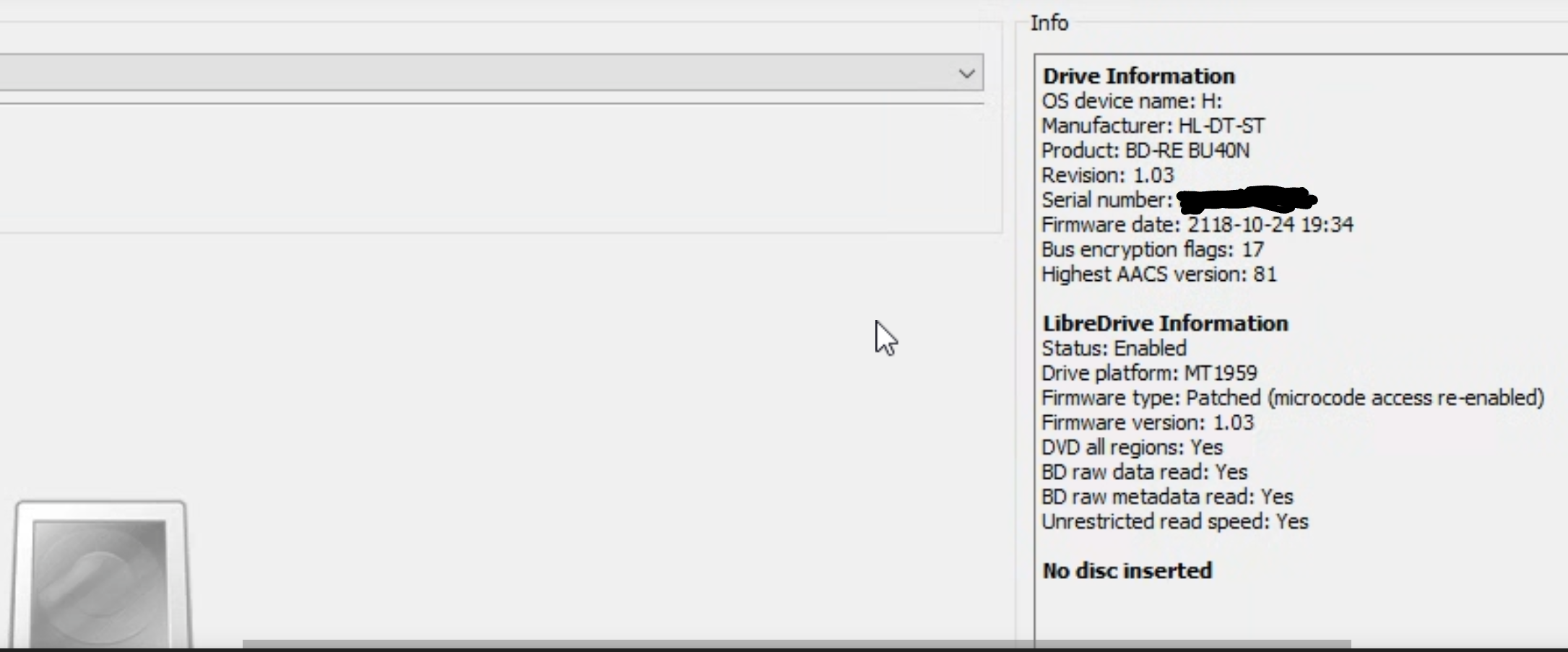

#2712 Post by mm13579 » Sat Feb 15, 2025 7:15 pm
I have this setup and could not get it to read any disc. It said loading then said no disc in drive. I updated firmware as seen in attachment. It now does Blu ray, but it still won't find a UHD disc and I tried several and rebooted the PC?
Also this used to work after I flashed the firmware on this same PC to 1.03 about 1 year ago. But tried this week and had to flash it again to the one displayed to get it to register any disc. Also I did clean both the disc lasers with a alcohol wipe as that was also stated to try.
Any ideas
Posts: 4280
#2713 Post by MartyMcNuts » Sat Feb 15, 2025 10:48 pm
Any ideas
Did yuo clean the UHD discs themselves? This is usually the first thing to do.
mm13579
Posts: 18
Joined: Tue Mar 10, 2020 11:26 am
#2714 Post by mm13579 » Sun Feb 16, 2025 12:37 am
I have cleaned them yes but I also have about 5 brand new UHDs I've tried and they are scratch free and cleaned with a cloth and there is nothing present on them?
Any other options, I even tried one in the past that worked with this UHD drive and now it doesn't about 1 year later?
It really doesn't make any sense to me
Posts: 4280
#2715 Post by MartyMcNuts » Sun Feb 16, 2025 2:11 am
Any ideas
What firmware was on it before?
What actual drive model is it?
