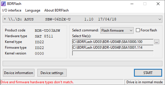

Thank you, Coopervid, for the information via PM.
Please see the following error message in red.
[color=#FF0000]Drive and firmware hardware types don't match.[/color]
[attachment=1]2025-01-23 (1).png[/attachment]

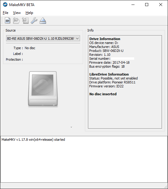

Would this be a case of using Force flash, or may there be another explanation?
[attachment=0]2025-01-23 (2).png[/attachment]
I await your advice.
Warm regards

Re: ASUS SBW-06D2X-U
Check the force flash box.plust wrote: Thu Jan 23, 2025 6:00 am Thank you, Coopervid, for the information via PM.
Warm regards

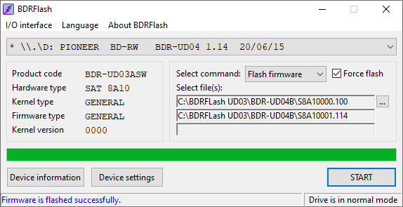

yup, you have got to "Tick" the force flash box for it to work its magic.
Ah!
Thank you, MartyMcNuts, Coopervid and Yethidran.
I just went back to the tutorial!
The results are amazing.
Best regards
Best regards
