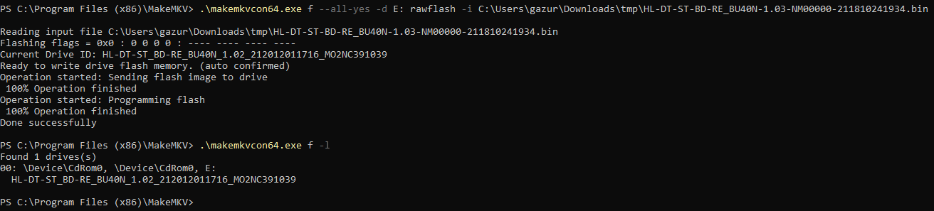

I am trying to flash but even though it says t hat it is successful, it is not5 actually updating the firmware. Any ideas?
Screenshot 2025-01-28 232316.png (34.14 KiB) Viewed 13407 times

Gazurk wrote: Wed Jan 29, 2025 6:26 am I am trying to flash but even though it says t hat it is successful, it is not5 actually updating the firmware. Any ideas?
rawflash enc
Gazurk
Joined: Wed Jan 29, 2025 6:24 am
Post by Gazurk » Thu Jan 30, 2025 4:47 am
MartyMcNuts wrote: Thu Jan 30, 2025 4:08 am
rawflash enc
Gosh thank you! It didn't show up on the enc list so I din't think to do that.
