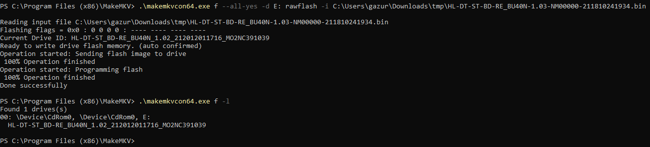

I am trying to flash but even though it says t hat it is successful, it is not5 actually updating the firmware. Any ideas?

Gazurk wrote: Wed Jan 29, 2025 6:26 am I am trying to flash but even though it says t hat it is successful, it is not5 actually updating the firmware. Any ideas?
rawflash enc

MartyMcNuts wrote: Thu Jan 30, 2025 4:08 am
rawflash enc
Gosh thank you! It didn't show up on the enc list so I din't think to do that.
