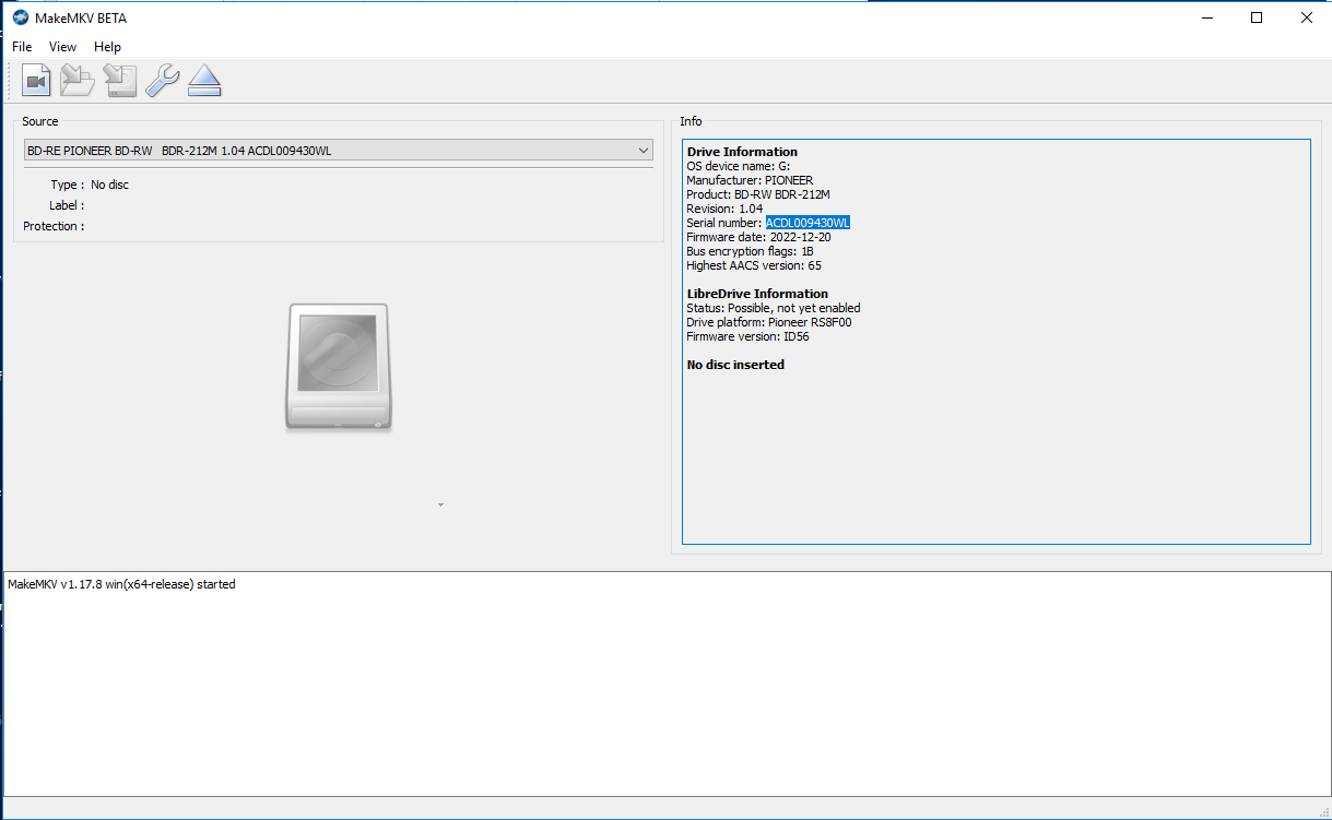

kempdawg83
Joined: Tue Mar 11, 2025 3:30 am
Re: Pioneer firmware update February 2023
Post by kempdawg83 »
Pretty sure I'm out of luck on my drive but wanted confirmation...
