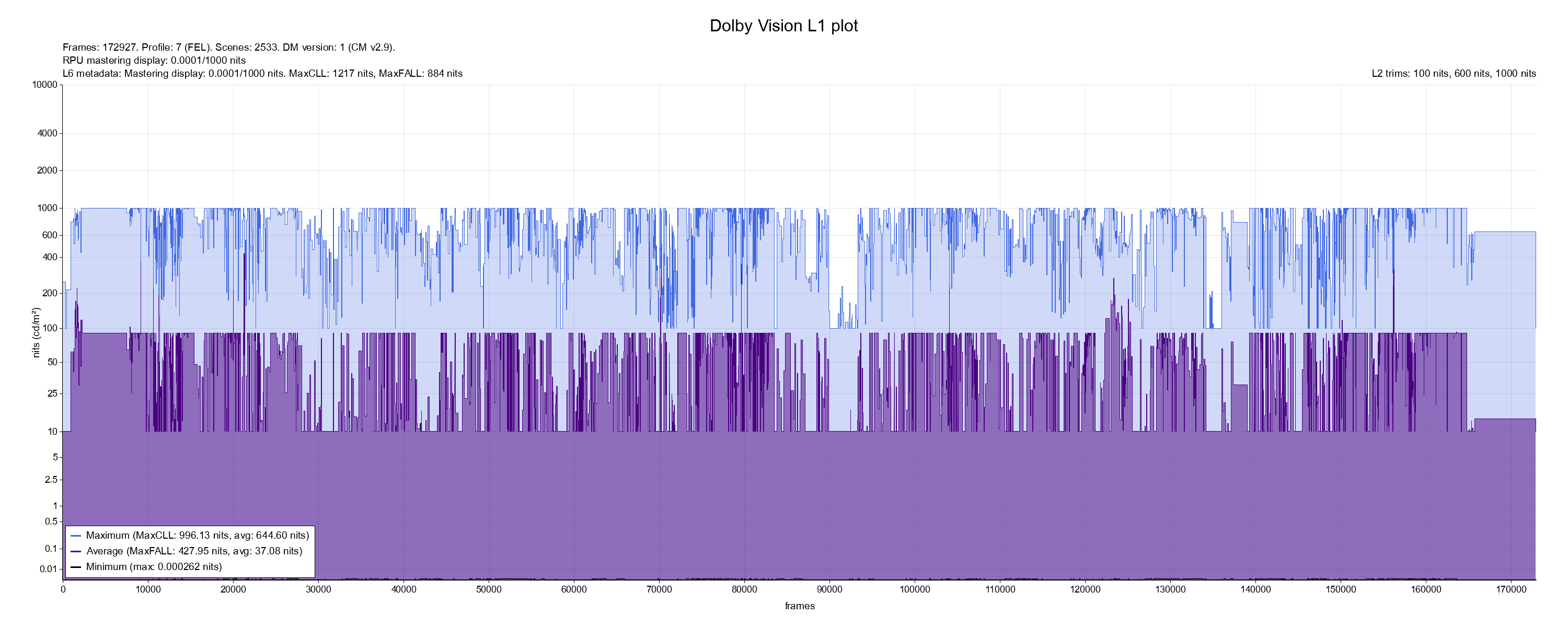

Hi, I'm just curious. I checked the FraMeSToR version which used the FRA UHD BD and MakeMKV. ffmpeg counts 172,927 frames and dovi_tool also counts 172,927 in the RPU as well. I've attached the plot. Is this release unaffected?
Parsing RPU file...
Summary:
Frames: 172927
Profile: 7 (FEL)
DM version: 1 (CM v2.9)
Scene/shot count: 2533
RPU mastering display: 0.0001/1000 nits
RPU content light level (L1): MaxCLL: 996.13 nits, MaxFALL: 427.95 nits
L6 metadata: Mastering display: 0.0001/1000 nits. MaxCLL: 1217 nits, MaxFALL: 884 nits
L2 trims: 100 nits, 600 nits, 1000 nits

powfu wrote: Sat Jan 18, 2025 1:06 am Hi, I'm just curious. I checked the FraMeSToR version which used the FRA UHD BD and MakeMKV. ffmpeg counts 172,927 frames and dovi_tool also counts 172,927 in the RPU as well. I've attached the plot. Is this release unaffected?
I don't know, I'll check it out.

Using the Zapax FRA UHD BD and MakeMKV 1.17.8, I get the same results.
Parsing RPU file...
Summary:
  Frames: 172927
  Profile: 7 (FEL)

Post by RESET_9999 » Sun Jan 19, 2025 10:54 pm
I dont know, I had an old rip so I assumed it was muxed with makemkv. Maybe not after all.
Some of my ST P7 rips were muxed with mkvtoolnix from DT P7 TS so that might be the reason.

Post by powfu » Sun Jan 19, 2025 11:41 pm
Alright, thank you. I guess this disc does not suffer from those issues then.
Just for posterity and completeness, using the Zapax FRA UHD BD and mkvmerge v89.0, the result is the same as above.
