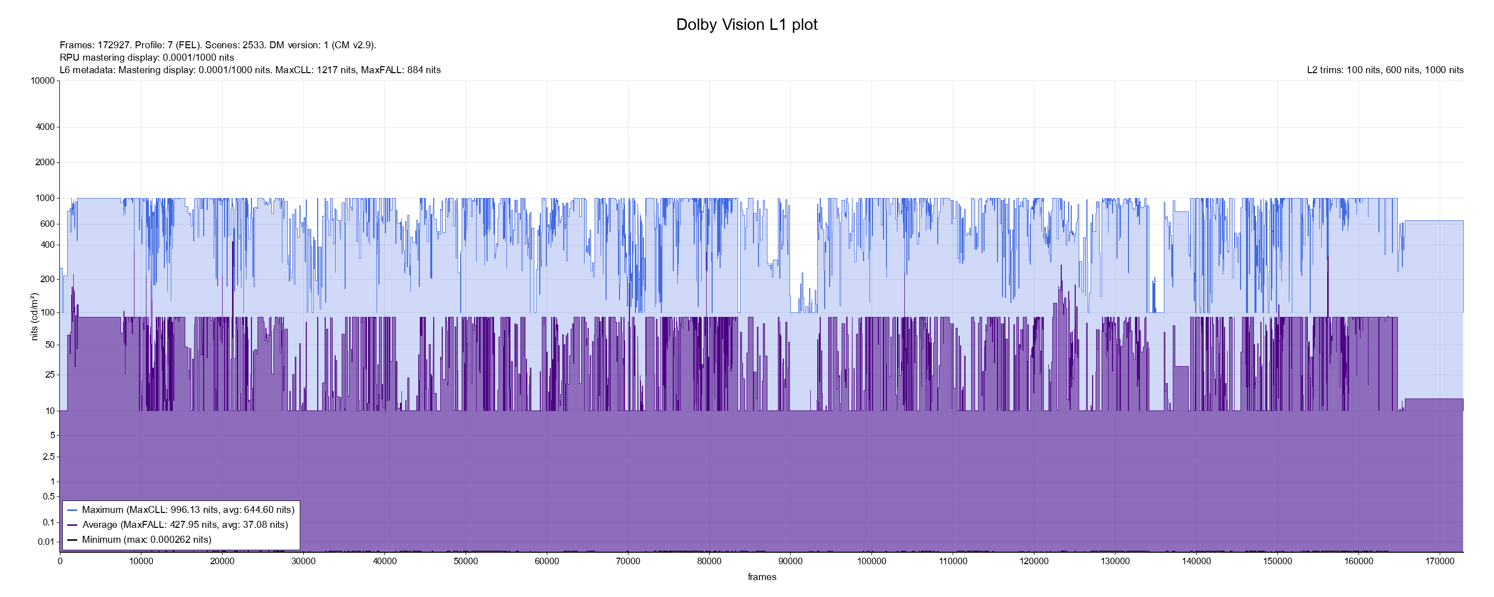

RESET_9999 wrote: Tue Nov 26, 2024 3:55 pm
RESET_9999 wrote: Sat Nov 09, 2024 1:50 pm anyway the problem is the EL and german discs
I wonder if all the French UHD-BD should be verified now. It looks like Blade 1998 FEL FRA BD has the same issue :(
https://slow.pics/c/YzYgHn4x
Hi, I'm just curious. I checked the FraMeSToR version which used the FRA UHD BD and MakeMKV. ffmpeg counts 172,927 frames and dovi_tool also counts 172,927 in the RPU as well. I've attached the plot. Is this release unaffected?
Parsing RPU file...
Summary:
Frames: 172927
Profile: 7 (FEL)
DM version: 1 (CM v2.9)
Scene/shot count: 2533
RPU mastering display: 0.0001/1000 nits
RPU content light level (L1): MaxCLL: 996.13 nits, MaxFALL: 427.95 nits
L6 metadata: Mastering display: 0.0001/1000 nits. MaxCLL: 1217 nits, MaxFALL: 884 nits
L2 trims: 100 nits, 600 nits, 1000 nits

AFAIK, it might matter which version of makeMKV is used, no? Could be how their encode wasn't affected. It does seem that it is worth verifying all EUR discs if using current version though.
powfu wrote: Sat Jan 18, 2025 1:06 am Hi, I'm just curious. I checked the FraMeSToR version which used the FRA UHD BD and MakeMKV. ffmpeg counts 172,927 frames and dovi_tool also counts 172,927 in the RPU as well. I've attached the plot. Is this release unaffected?
I don't know, I'll check it out.

RESET_9999 wrote: Sat Jan 18, 2025 4:51 am
Using the Zapax FRA UHD BD and MakeMKV 1.17.8, I get the same results.

I dont know, I had an old rip so I assumed it was muxed with makemkv. Maybe not after all.
Some of my ST P7 rips were muxed with mkvtoolnix from DT P7 TS so that might be the reason.
powfu
Joined: Sat Jan 18, 2025 12:57 am
Post by powfu »
Alright, thank you. I guess this disc does not suffer from those issues then.
Just for posterity and completeness, using the Zapax FRA UHD BD and mkvmerge v89.0, the result is the same as above.
