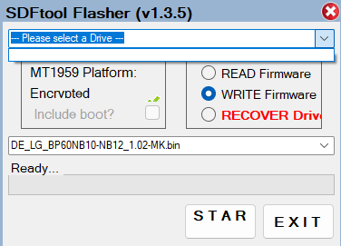

I am trying to flash my LG BP60NB10 and when I have my SDFtool open and ready to choose drive and firmware, then drop down menu of drive will not display my drive. Anyone got any tips for this?
Please and thank you.

corefunctions wrote: Wed Jan 15, 2025 8:07 am I am trying to flash my LG BP60NB10 and when I have my SDFtool open and ready to choose drive and firmware, then drop down menu of drive will not display my drive. Anyone got any tips for this?
Do you have MakeMKV installed and in the default location?

I have MakeMKV set up on my Mac but it's not able to open SDFTool so I used my friends PC to try and upload the software, but he doesn't have MakeMKV downloaded. This is what I see and my Player is connected and being read by the laptop.
Screenshot 2025-01-17 102026.png (16.48 KiB) Viewed 43089 times
