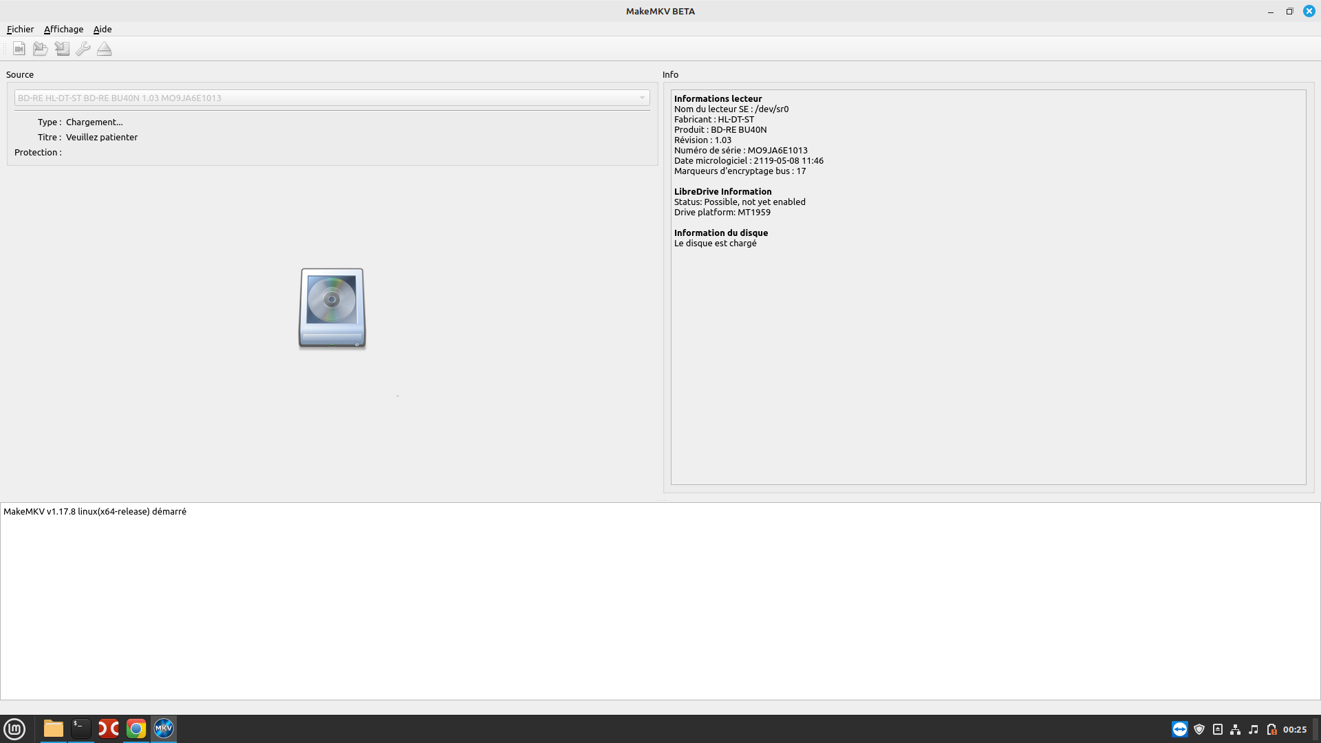

Good evening everyone,
I recently switched from Windows to Linux Mint. While my BD-RU BU40N player worked fine for BDs under Windows, it seems to be stuck under Linux. When I put a disc in the player, I then launch MakeMKV, the disc loads but it does nothing more....
Without much hope I tried the reverse operation, but as I expected it did not change anything.
In the image above, we see that LibreDrive is possible, but not activated. Could my problem come from there?
I am a beginner in this area, so thank you for being understanding enough.
Thank you in advance.

- Posts: 6149
Re: Ultimate UHD Drives Flashing Guide Updated 2024
for linux you need to be on DE fw for some drives not sure why or if this can be fixed i have reported this many timesKarlemagne wrote: Wed Dec 25, 2024 11:36 pm Good evening everyone,

Karlemagne
- Posts: 3
- Joined: Wed Dec 25, 2024 11:24 pm
Good morning,
My player is natively in 1.03, so I have to downgrade it to 1.00?
I got version 1.00, is there a tutorial for downgrading under Linux Mint? The one indicated in the first post of this topic is only for Mac. I specify that I am a complete beginner in command line....
Thanks for your feedback.

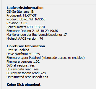

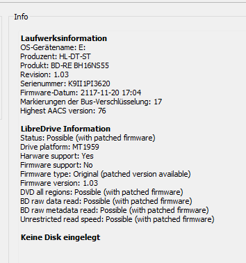

Hey everyone. I have flashed my BD Drive today and ever since that, the ripping process sometimes take a stop. Like it does 5 minutes and then it just stops for another 5 minutes before starting to finish ripping.
I went from: to this Did I break anything or is this something known? Couldnt find anything on the quick search besides that sleep bug, but that doenst quite describe whats happening for me.

- Posts: 5054
Why would you do that???!?!??!!??Fuschy wrote: Thu Dec 26, 2024 9:35 pm Hey everyone. I have flashed my BD Drive today and ever since that, the ripping process sometimes take a stop. Like it does 5 minutes and then it just stops for another 5 minutes before starting to finish ripping.
I went from: makemkv_W8GZq9zzqU.png to this makemkv_lKt4CPv5HY.png
WH16NS60 1.02-MK is the recommended firmware. It is faster and removes the sleep bug. You've just given yourself a slower, buggy firmware that also has the sleep bug.
Fuschy
- Posts: 2
- Joined: Thu Dec 26, 2024 9:32 pm
My bad. I accidentally swapped the pictures. I went from the stock BH16NS55 1.03 to WH16NS60 1.02.MartyMcNuts wrote: Thu Dec 26, 2024 11:55 pm
And since the flashing this bug happens.
Karlemagne
- Posts: 3
Good evening,Karlemagne wrote: Thu Dec 26, 2024 9:58 am Good morning,
After much research and testing, I finally managed to flash my player. I retrieved the file "_private_data.tar" available at the end of the 1st post of this topic to put it in place of the one created when launching MakeMKV. After flashing, LibreDrive is finally activated and I find normal operation of the software. However, now I have an error message that appears when I try to rip a DVD:
I tried firmware 1.03MK, 1.04MK, and finally DE 1.00, but it doesn't change anything.Erreur 'Erreur SCSI - ILLEGAL REQUEST:READ OF SCRAMBLED SECTOR WITHOUT AUTHENTICATION' survenue à la lecture de 'BD-RE HL-DT-ST BD-RE BU40N 1.00 MO9JA6E1013' à l'offset '1048576'
However, when I switch to the Lord of the Rings Blue-Ray I don't have an error, so maybe it's the DVD that has a problem.
Thanks anyway for the answers I got.
- Posts: 5054
Not possible as the WH16NS60 is an official UHD drive thus it's firmware does not have the sleep bug. What you describe is not the sleep bug. That sort of thing happens with LG drives when it is having trouble reading some sections of the disc. It also happens at layer changes. The main thing is that is finishes the rip. Honestly, LG 5.25" drives are always fluctuating in speed. They rarely stay at the same speed for long.Fuschy wrote: Fri Dec 27, 2024 9:44 amMy bad. I accidentally swapped the pictures. I went from the stock BH16NS55 1.03 to WH16NS60 1.02.MartyMcNuts wrote: Thu Dec 26, 2024 11:55 pm
Pioneer drives are so much better! They rip at a far more consistant speed with no concern over if it will complete the rip or not.
