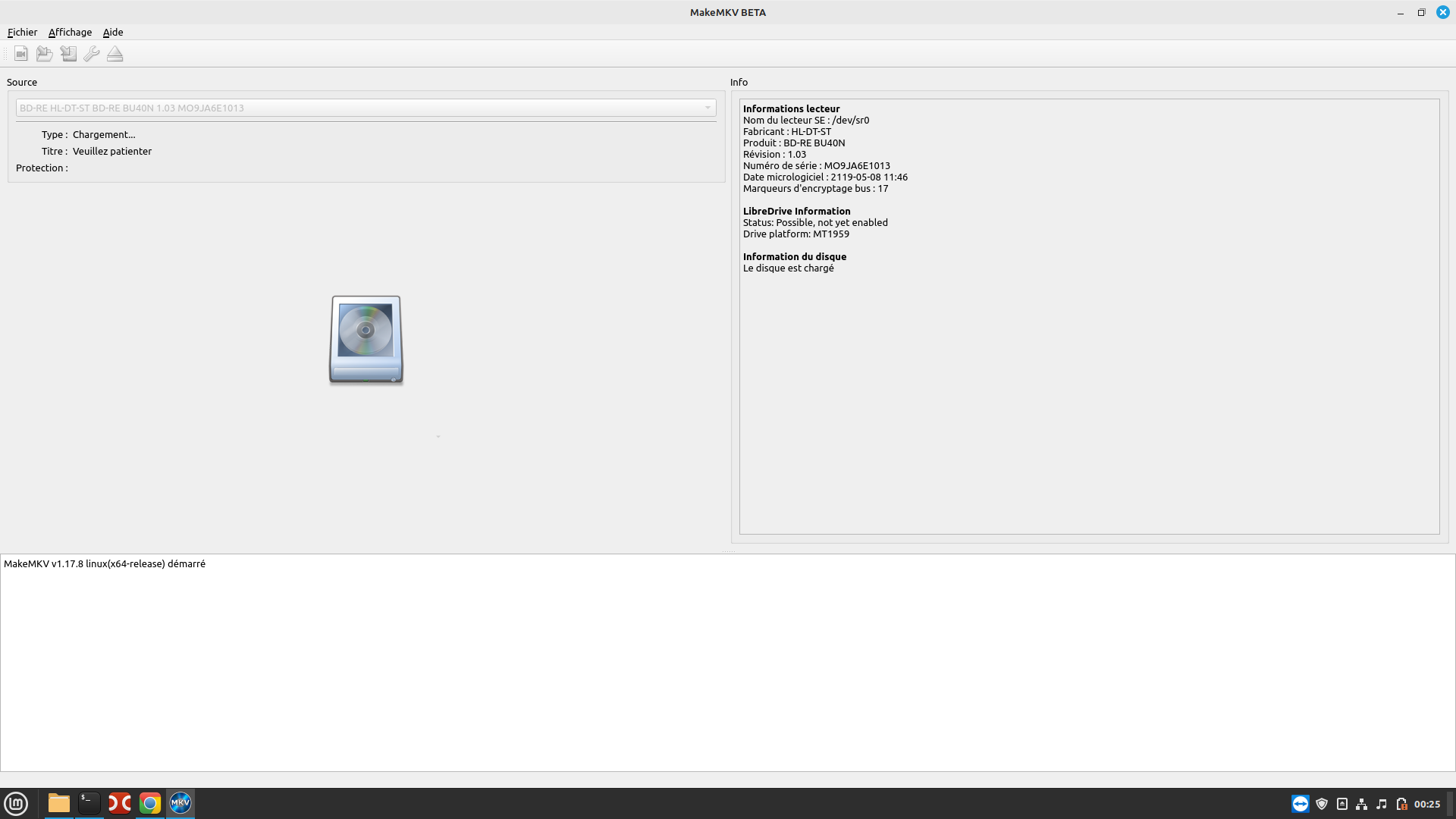

Good evening everyone,
I recently switched from Windows to Linux Mint. While my BD-RU BU40N player worked fine for BDs under Windows, it seems to be stuck under Linux. When I put a disc in the player, I then launch MakeMKV, the disc loads but it does nothing more....
Capture d’écran du 2024-12-26 00-25-57.png (86.58 KiB) Viewed 12033 times
Without much hope I tried the reverse operation, but as I expected it did not change anything.
In the image above, we see that LibreDrive is possible, but not activated. Could my problem come from there?
I am a beginner in this area, so thank you for being understanding enough.
Thank you in advance.

Karlemagne wrote: Wed Dec 25, 2024 11:36 pm Good evening everyone,
for linux you need to be on DE fw for some drives not sure why or if this can be fixed i have reported this many times
go to BU40N 1.00

Good morning,
My player is natively in 1.03, so I have to downgrade it to 1.00?
I got version 1.00, is there a tutorial for downgrading under Linux Mint? The one indicated in the first post of this topic is only for Mac. I specify that I am a complete beginner in command line....
Thanks for your feedback.

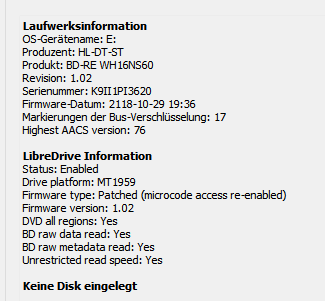

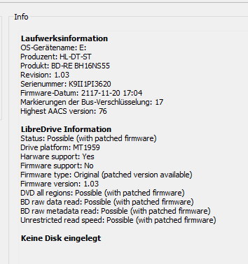

Hey everyone. I have flashed my BD Drive today and ever since that, the ripping process sometimes take a stop. Like it does 5 minutes and then it just stops for another 5 minutes before starting to finish ripping.
I went from:
to this
Did I break anything or is this something known? Couldnt find anything on the quick search besides that sleep bug, but that doenst quite describe whats happening for me.
Posts: 4914
Re: Ultimate UHD Drives Flashing Guide Updated 2024
Fuschy wrote: Thu Dec 26, 2024 9:35 pm Hey everyone. I have flashed my BD Drive today and ever since that, the ripping process sometimes take a stop. Like it does 5 minutes and then it just stops for another 5 minutes before starting to finish ripping.
I went from: makemkv_W8GZq9zzqU.png to this makemkv_lKt4CPv5HY.png
Why would you do that???!?!??!!??
WH16NS60 1.02-MK is the recommended firmware. It is faster and removes the sleep bug. You've just given yourself a slower, buggy firmware that also has the sleep bug.

MartyMcNuts wrote: Thu Dec 26, 2024 11:55 pm
My bad. I accidentally swapped the pictures. I went from the stock BH16NS55 1.03 to WH16NS60 1.02.
And since the flashing this bug happens.

Good evening,
After much research and testing, I finally managed to flash my player. I retrieved the file "_private_data.tar" available at the end of the 1st post of this topic to put it in place of the one created when launching MakeMKV. After flashing, LibreDrive is finally activated and I find normal operation of the software. However, now I have an error message that appears when I try to rip a DVD:
Erreur 'Erreur SCSI - ILLEGAL REQUEST:READ OF SCRAMBLED SECTOR WITHOUT AUTHENTICATION' survenue à la lecture de 'BD-RE HL-DT-ST BD-RE BU40N 1.00 MO9JA6E1013' à l'offset '1048576'
I tried firmware 1.03MK, 1.04MK, and finally DE 1.00, but it doesn't change anything.
However, when I switch to the Lord of the Rings Blue-Ray I don't have an error, so maybe it's the DVD that has a problem.
Thanks anyway for the answers I got.
