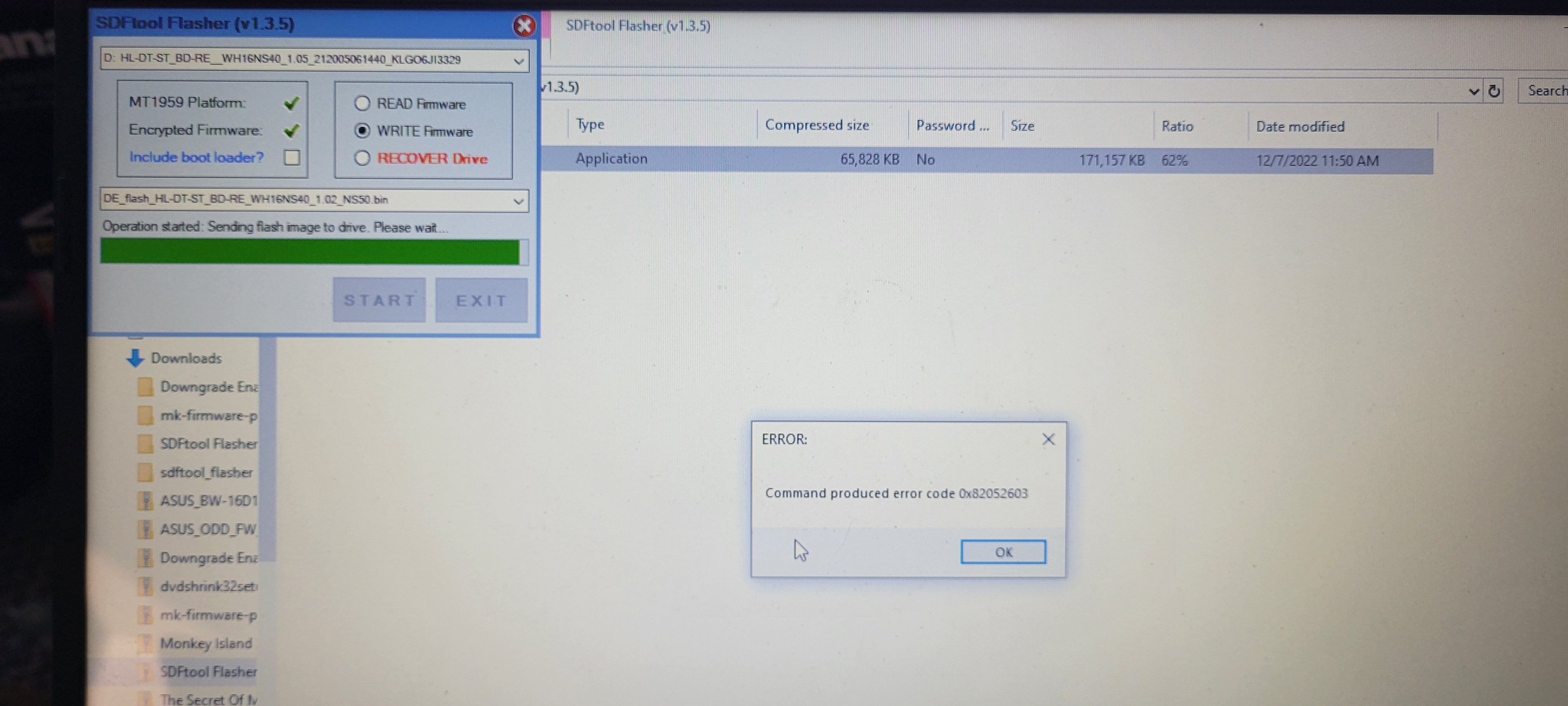

#2567 Post by MrMegadeth99 » Thu Dec 12, 2024 1:49 pm
I used the SDFToolflasher and got this error code. Do you know what this means?

MrMegadeth99 wrote: Thu Dec 12, 2024 1:49 pm I used the SDFToolflasher and got this error code. Do you know what this means?
Are you in panic mode???
Now you are trying to flash DE_WH16NS40 1.02. You are supposed to flash WH16NS60 1.02. Only after a succesful flash you can also flash other firmware. You understand xxx60 instead of xxx40.
Thee guide recommends...
WH16NS40 on any Firmware directly to > WH16NS60 1.02MK
Download the 'all you need firmware pack' & extract 'HL-DT-ST-BD-RE_WH16NS60-1.02-NM00100-211810291936.bin'. Flash that.

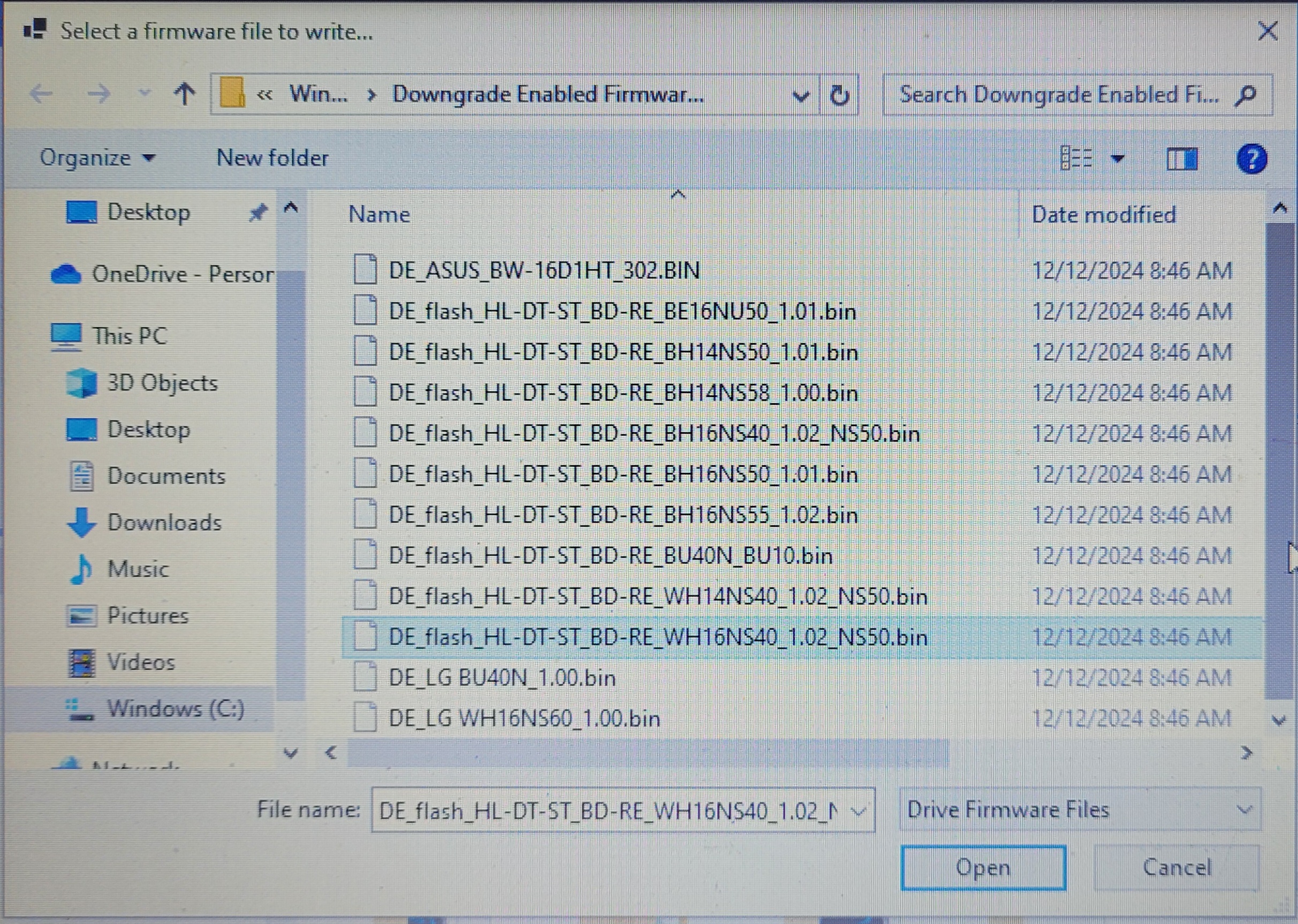

#2570 Post by MrMegadeth99 » Thu Dec 12, 2024 2:03 pm
How do I do that? I only have the options below. I tried the LG WH16NS60 but got the same error code.

#2571 Post by Coopervid » Thu Dec 12, 2024 2:06 pm
MrMegadeth99 wrote: Thu Dec 12, 2024 2:03 pm How do I do that? I only have the options below. I tried the LG WH16NS60 but got the same error code.
You need the MK firmware pack, not the downgrade enabled firmware pack. In the MK firmware pack look under the folder OLD.
Or also the all you need firmware pack from Marty listed where SDFToolFlasher is available.

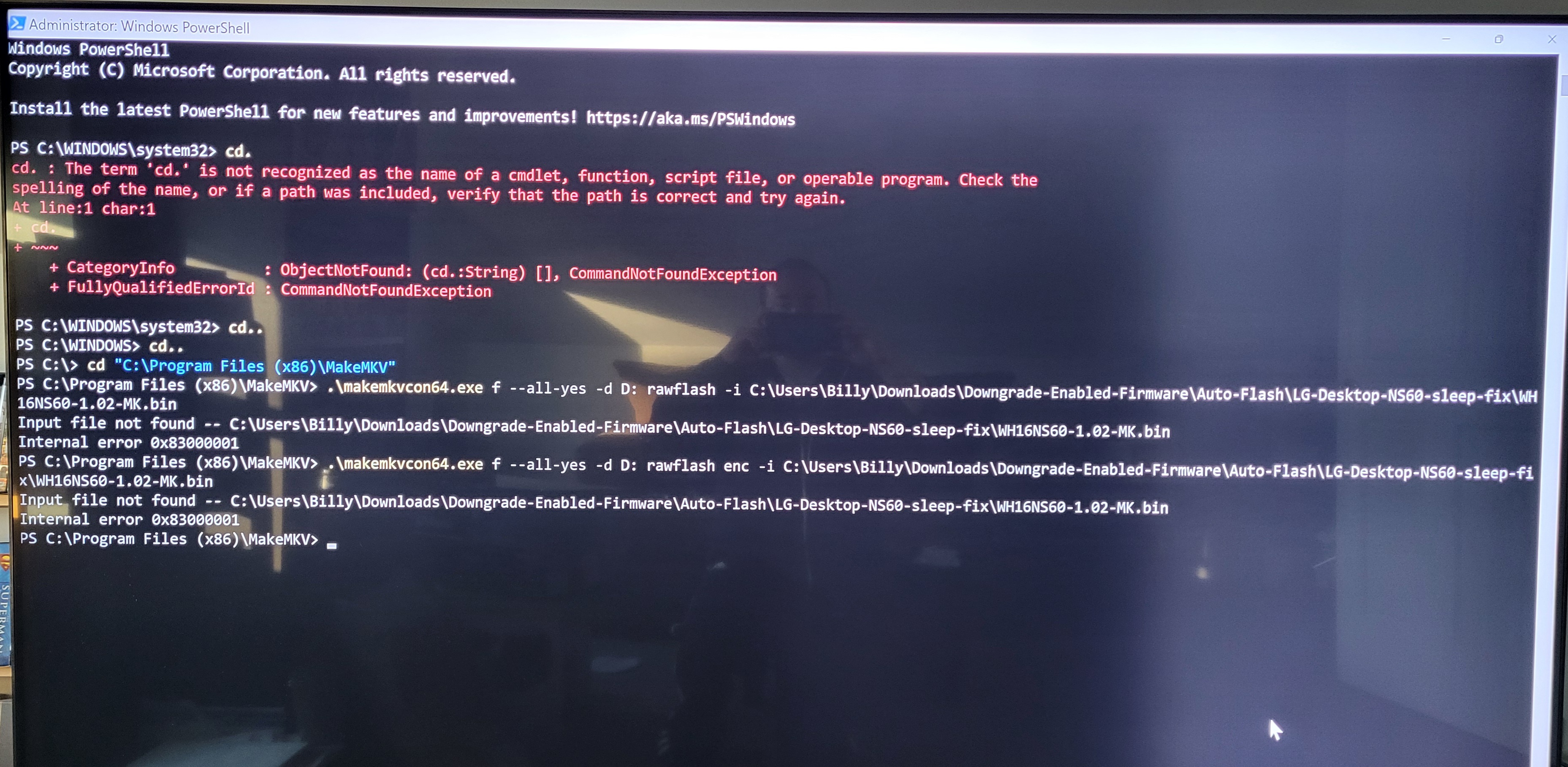

where did you get those commands?
your copying my directory's thats not going to work

Yes it worked not thanks.
What commands?

The directory path you used in your power shell script: Billy blahblah. We are sure that directory doesn't exist on your computer.

No clue I just followed the YouTube video

I see. But that was an example with the file locations on Billy's computer. Your computer had for sure another file location for the .bin files. You should have read the guide here thoroughly and on Windows use SDFToolFlasher which is the easiest way to do it. And you didn't follow the recommendation then what to flash. Call yourself lucky that you didn't screw up your drive regarding everything you did wrong. Fortunately you didn't try to flash a firmware of a slim drive but otherwise somebody can't make almost do more mistakes. In the future please don't do stuff anymore the way you do it.
