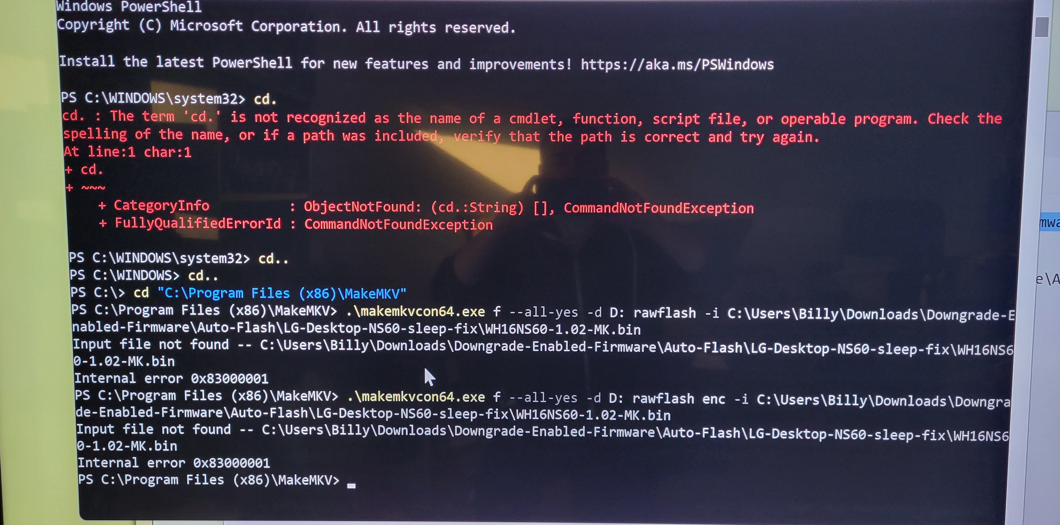

I have an LG WH16NS40 that was working fine with 1.02 LibreDrive firmware. Then I found that mk-firmware-pack-20200720.zip had a 1.05 LibreDrive firmware and I thought "newer must be better, I'll get the LG bug fixes plus keep LibreDrive". Things seemed ok. I would occasionally get read errors, but chalked it up to invisible disc damage.
Recently, I pulled a disc out of the shrink wrap to rip it and got read errors. I reverted back to 1.02 firmware and the disc ripped fine. Lesson learned; bigger numbers are not always better. I should have listened to this guide and stayed with 1.02.

Keat1892 wrote: Tue Dec 10, 2024 9:13 pm I have an LG WH16NS40 that was working fine with 1.02 LibreDrive firmware. Then I found that mk-firmware-pack-20200720.zip had a 1.05 LibreDrive firmware and I thought "newer must be better, I'll get the LG bug fixes plus keep LibreDrive". Things seemed ok. I would occasionally get read errors, but chalked it up to invisible disc damage.
WH16NS60 1.02 from that firmware pack is the recommended firmware for your drive and it fixes the sleep bug.

I tired that for both encrypted and unencrypted and get error for both. My drive is WH16NS40. Can someone please tell me what I'm doing wrong?
The firmware file name is usually much longer compared to what you typed. Did you rename it? Why don't you use SDFToolflasher?

I copied exactly what the guy in the YouTube video did and it. How do I use the SDFToolFlasher with this?
