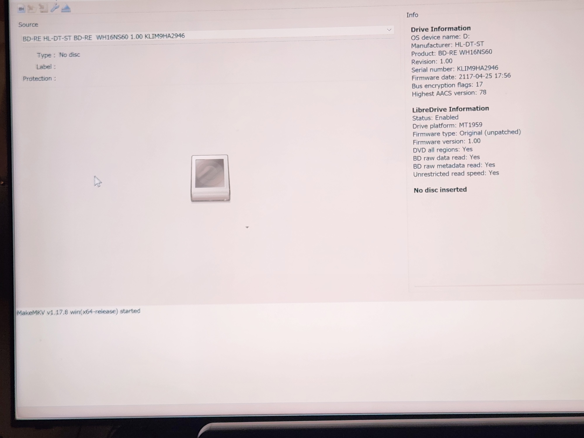

Indeed, that's what MakeMKV reported when he sent me the screenshot. In fact, everything listed was exactly as it was prior to flashing. How this happened without him doing anything is beyond me.
I walked him step-by-step through the exact process I used to successfully upgrade before but unfortunately it still no longer supports 4K. The odd thing is, MakeMKV lists the drive info as successfully upgraded to 1.02, all enabled/patched, etc.
So basically, it went from successfully upgraded a year ago, to randomly reverted, to (supposedly) successfully reflashed yet not truly supporting 4K.

#6 Post by takearushfan » Fri Nov 01, 2024 4:28 pm
Here's the screenshot. Is there something else we can try first before resorting to it being the laser?

#7 Post by takearushfan » Fri Nov 01, 2024 4:35 pm
Ugh, I didn't realize the screenshot i just posted is the old one, prior to us trying to reflash. Do you need the new screenshot, showing 1.02 FW?

#8 Post by takearushfan » Fri Nov 01, 2024 4:42 pm
Okay, here's the screenshot of what is reported Now, not prior to flashing.
