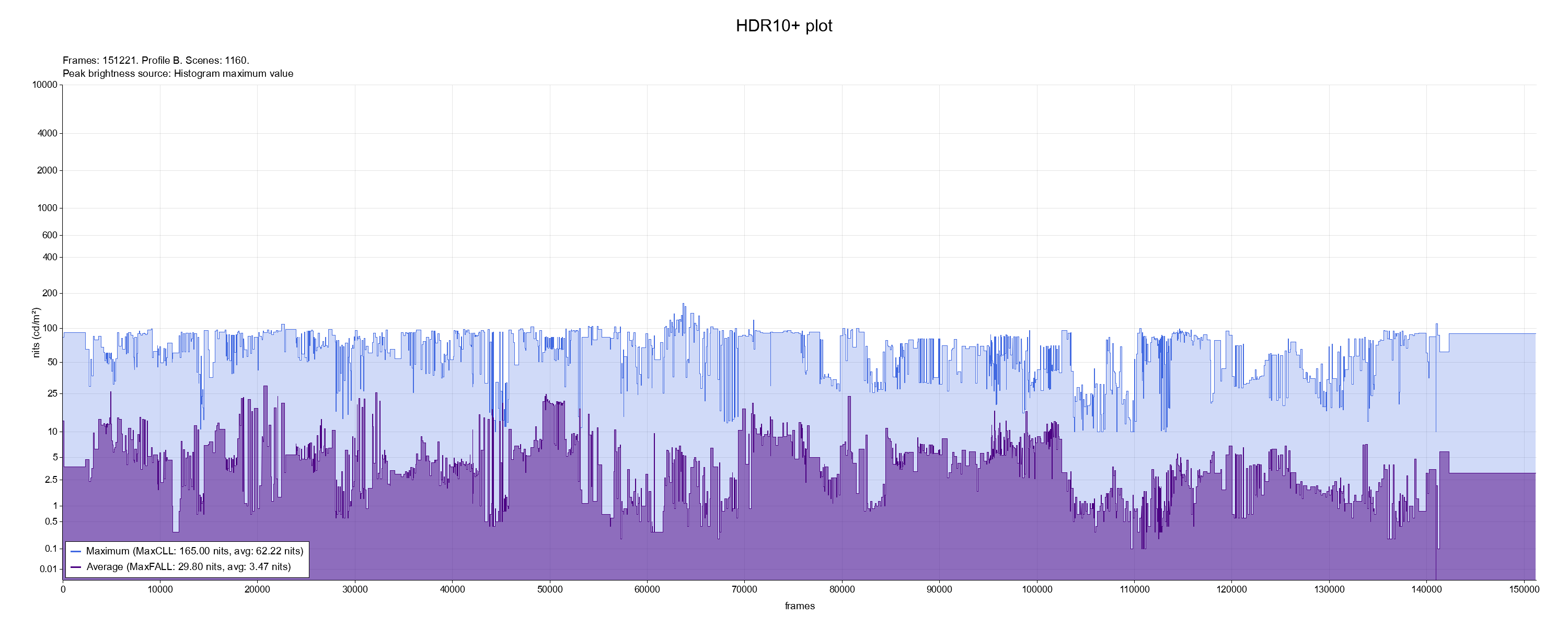

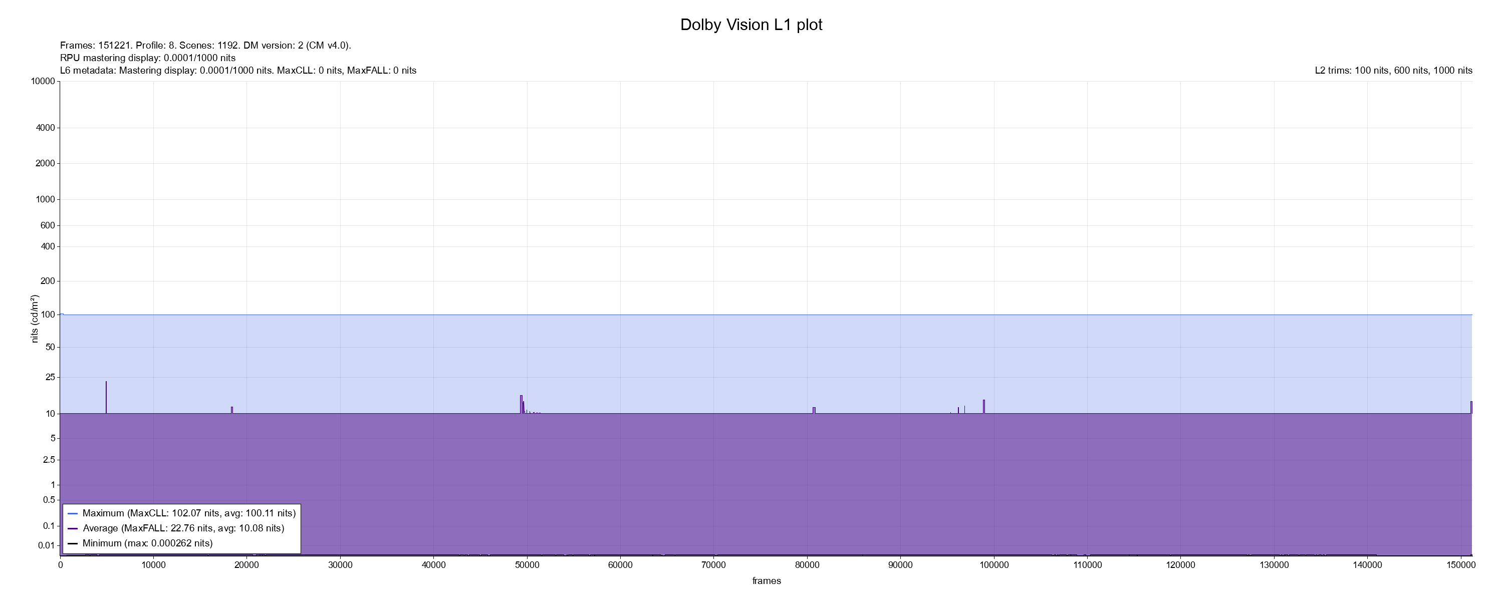

#10415 Post by staknhalo » Tue Oct 29, 2024 2:43 pm
I dunno what the hell is going on with these titles (besides whoever not caring)- but if you guys look at the web and disc DV plot for Trap 2024 and web DV plot for Longlegs 2024 - there's almost no point to the DV metadata it looks like - yet the HDR10+ (from web for each) shows a lot more 'activity' - I only really looked and noticed it with these two so far, wonder how many others (I'm guessing since they started doing DV and HDR10+ together on recent iT/MA webs) are like this :|
Here's Trap to show what I mean
#10416 Post by RESET_9999 » Tue Oct 29, 2024 3:07 pm
It's because DV has a 100nits floor(except the earliest version of the algo) for L1 and values under 100nits are not allowed.
It wouldn't matter anyway because any L1 value below your TV target tells the TV to not do any tone mapping. So if you have a 800nits TV, any value between 100-800nits wont have any effect(as long as avg is not too high).
For example on my 800nits C2:
avg pq = 10nits:
rpu starts dimming around 850-900nits L1, any metadata below that has no effect (image is clipped because of that) and the higher the metadata gets, the dimmer the image gets.
avg_pq = 92 nits:
rpu start dimming earlier, around 650-700nits L1
avg_pq higher:
rpu start dimming even earlier.
You can test your own TV target relation with L1 using these files: https://drive.google.com/drive/u/1/fold ... HnkomkdsXm

#10417 Post by staknhalo » Tue Oct 29, 2024 3:22 pm
RESET_9999 wrote: Tue Oct 29, 2024 3:07 pm It's because DV has a 100nits floor(except the earliest version of the algo) for L1 and values under 100nits are not allowed.
avg pq = 10nits:
avg_pq = 92 nits:
avg_pq higher:
P-S I re-graded both movies :P
So for titles like that would I be ok throwing DV out and just going HDR10 if not regrading/using your DV, or I should keep it for the color/trim/other stuff in the other levels of metadata still, right (because there is still some actual data there in L1 showing it's not empty, even if just being ignored/discarded as it should as you said)?
Was this maybe what was going on with the French Dredd 2012 disc too or was that one still just empty/blank metadata?
#10418 Post by RESET_9999 » Tue Oct 29, 2024 3:28 pm
It depends on how your TV handles the HDR10 static metadata and how the HDR10 encode metadata is set.
For example if the movie HDR10 doesn't have maxcll/fall avlues with a 4000nits MDL, the tone mapping curve your TV will use might introduce some tone mapping even if the content is at SDR level.
in other words, it's safer to use DV even if the values are within your TV target.

#10420 Post by RESET_9999 » Tue Oct 29, 2024 3:55 pm
No,
static DV metadata for a movie graded in the 1000-4000nits is not good and probably worse than static HDR10 because DV metadata is a lot more aggressive than HDR10 static curves.
For example if you have a 4000nits grade with a static 1000nits DV metadata. All the low-nits scenes will be darker and the brighter scenes will be more clipped than proper HDR10 metadata tone mapping curve. It's practically the same as making a DV P8 hybrid using two sources with different brightness, as shown here: https://www.youtube.com/watch?v=236athosits
Those movies with static DV are not done properly and should be avoided...
Trap is done properly because the content is below the DV 100nits floor (min)
