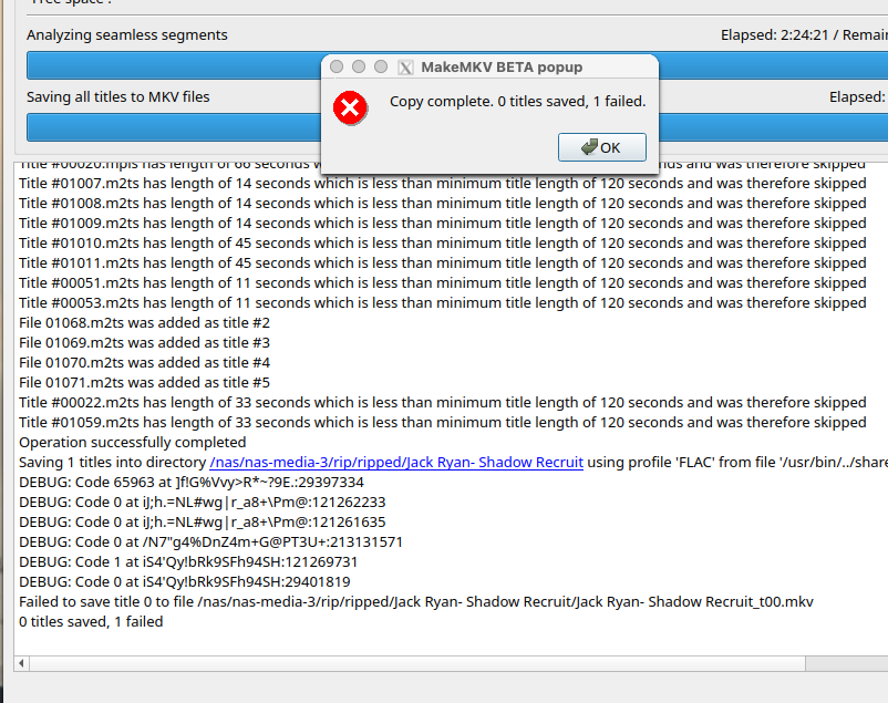

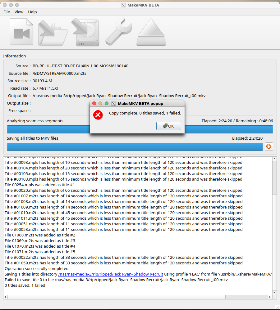

So, this is strange. I am trying to rip a bd I purchased at the store. When I run makeMKV on it, it fails, but there are no error message and no hints as to why it failed.
I've enabled debug logging and seeing if that provides any additional clues. More to come. But if anyone has any thoughts on this or if they've seen this before, much would be appreciated. I'm using a purchased license. At first figured there might be something wrong with the disc. I was able to watch the entire movie from the same drive in which I'm ripping the film. So now I'm not sure what the problem is.
== update ==
I got an interesting debug output after enabling debug logging:
== update ==
Re: If you're experiencing rip errors, please read here first!
The error is saying it couldn't save the file, and the lack of any intervening messages from the read often means that something blocked the write. You've tested the write to that path, correct?
If it isn't permissions, then it's lack of space.Woodstock wrote: Thu Sep 26, 2024 5:47 pm The error is saying it couldn't save the file, and the lack of any intervening messages from the read often means that something blocked the write. You've tested the write to that path, correct?
I have. Moreover, MakeMKV is able to create the directory just fine. I have plenty of space on the file system. I'll check a few other things. A clearer error message would have been nice, though.Woodstock wrote: Thu Sep 26, 2024 5:47 pm The error is saying it couldn't save the file, and the lack of any intervening messages from the read often means that something blocked the write. You've tested the write to that path, correct?
Create the file locally then move it to the NAS. See if that works. If it does, there could some sort of file locking issue on the NAS when it reaches the point where it attempts to close the file.cloaked1 wrote: Fri Sep 27, 2024 7:38 amI have. Moreover, MakeMKV is able to create the directory just fine. I have plenty of space on the file system. I'll check a few other things. A clearer error message would have been nice, though.Woodstock wrote: Thu Sep 26, 2024 5:47 pm The error is saying it couldn't save the file, and the lack of any intervening messages from the read often means that something blocked the write. You've tested the write to that path, correct?
