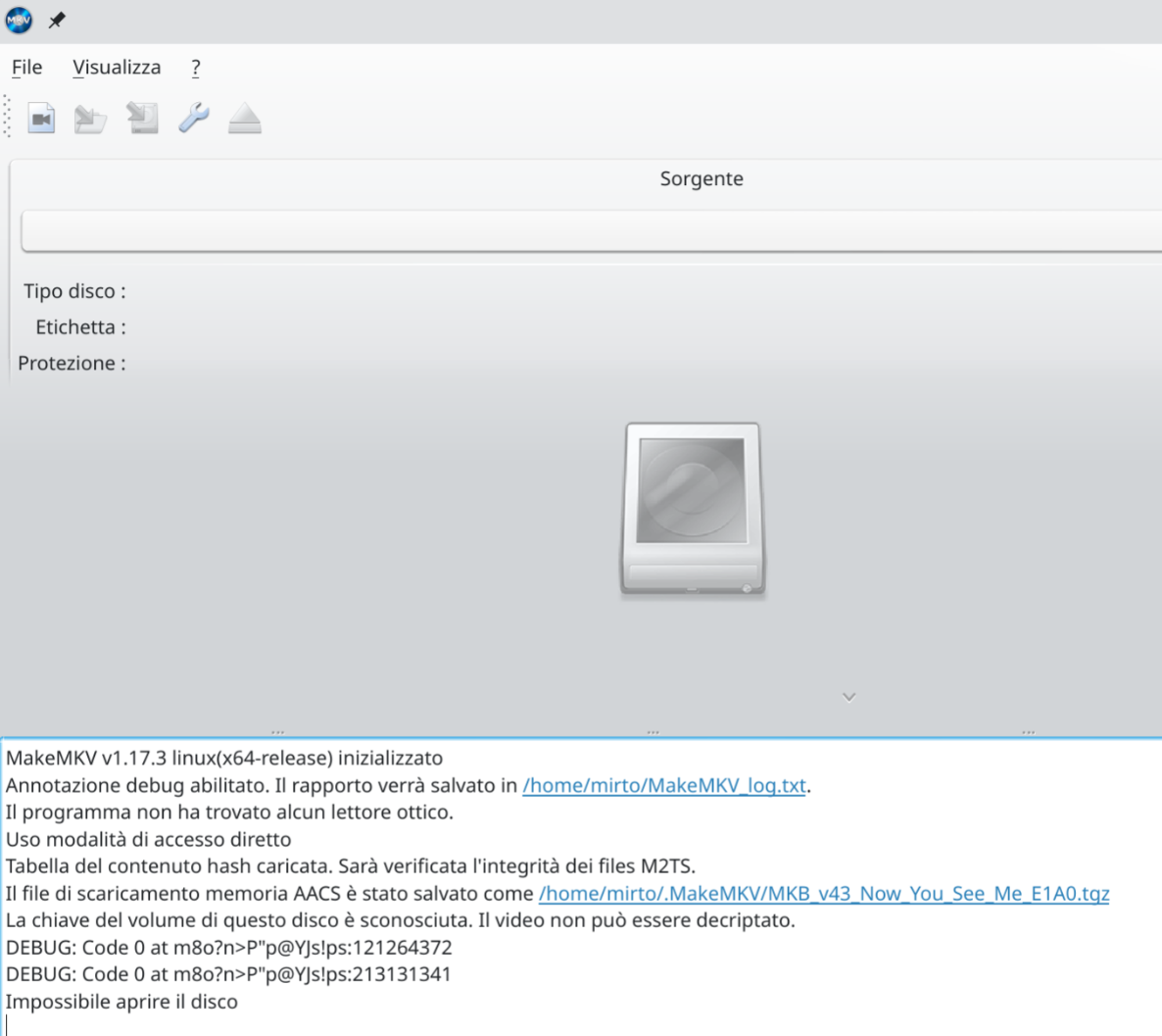

When I try to open a BD iso image it fails saying
MakeMKV v1.17.3 linux(x64-release) inizializzato
Il programma non ha trovato alcun lettore ottico.
Uso modalità di accesso diretto
Tabella del contenuto hash caricata. Sarà verificata l'integrità dei files M2TS.
Il file di scaricamento memoria AACS è stato salvato come /home/XXXXXXX/.MakeMKV/MKB_v43_Now_You_See_Me_E1A0.tgz
La chiave del volume di questo disco è sconosciuta. Il video non può essere decriptato.
Impossibile aprire il disco
If I open the same iso image with VLC it works perfectly.
Seems that makemkv cannot reach the KEYDB.cfg file.
What can I do?

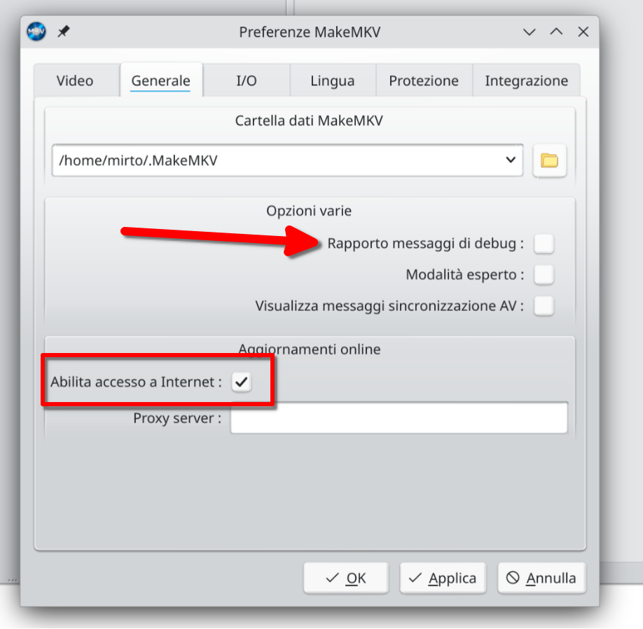

The log will tell whether or not MakeMKV can reach the internet. If your logging settings are set high enough, that is. The default is rather low, in my opinion, but it is easily switched.
In program settings, General, "Enable Internet access" checked sets that up. It's been checked so long on my copies that I can't remember if it is automatic or not. :)

Post by mirto » Tue Mar 28, 2023 5:36 pm
Well, it seems that internet access is already enabled.
Have i to select the debug log option and try again to give more information?

Yes, add a check mark for debug information being recorded. Your log window will show more stuff, and the log FILE for the application will grow even more.
You should be able to tell from the log file if it is able to download the disc decryption data, or if it had an error doing so.

The window log was
MakeMKV v1.17.3 linux(x64-release) started
Debug logging enabled, log will be saved as /home/mirto/MakeMKV_log.txt
The program can't find any usable optical drives.
DEBUG: Code 16842752 at '5BE>tA"Gf|~89y(o3:121264027
Using direct disc access mode
Saved AACS dump file as /home/mirto/.MakeMKV/MKB_v43_Now_You_See_Me_E1A0.tgz
DEBUG: Code 0 at m8o?n>P"p@YJs!ps:121264372
DEBUG: Code 0 at m8o?n>P"p@YJs!ps:213131341
Failed to open disc
